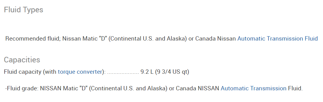

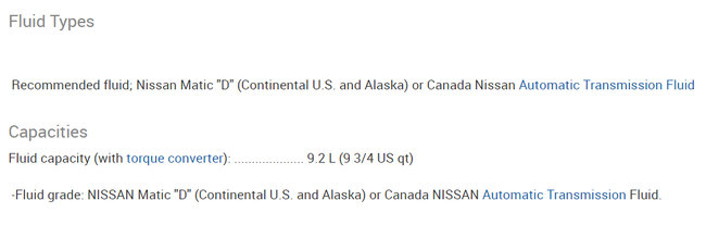

I've attached a picture below with the transmission fluid type and capacity below. Hope this helps and thanks for using 2CarPros.

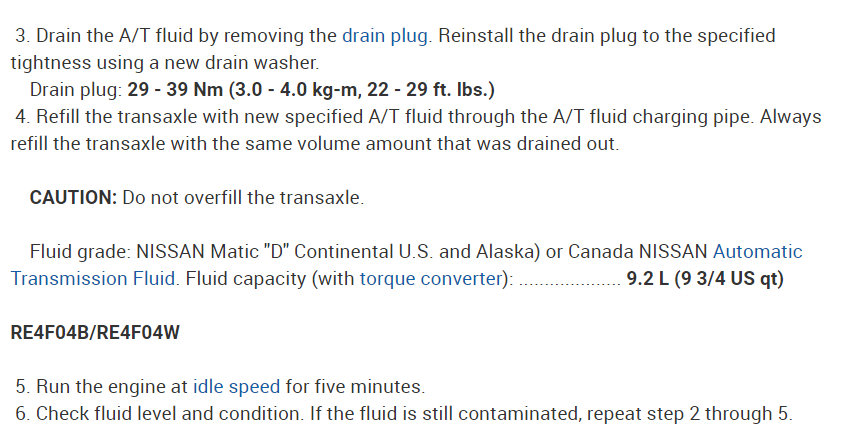

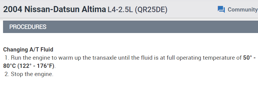

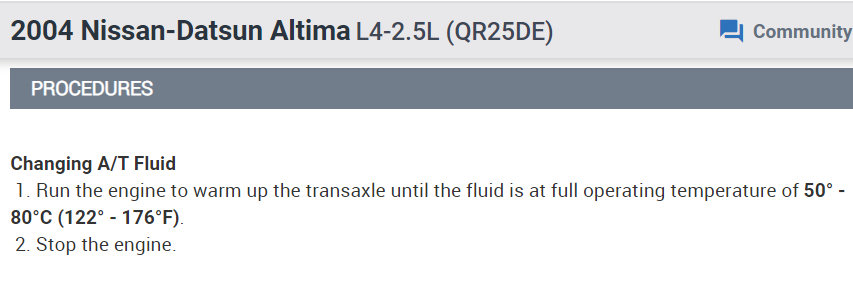

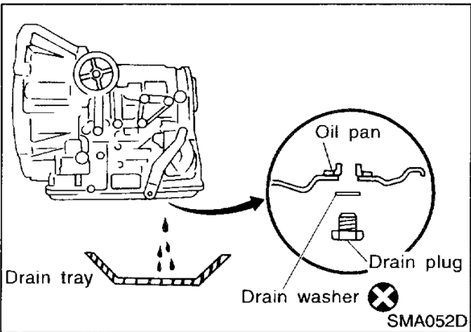

Hello again.
I've attached picture steps below for transmission service on your car. Hope this helps and thanks again for using 2CarPros.
