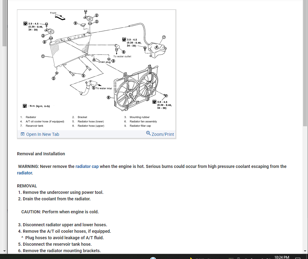

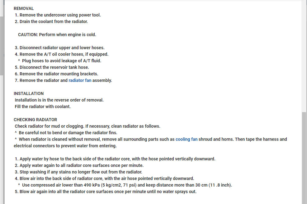

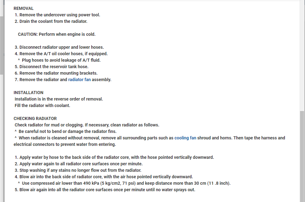

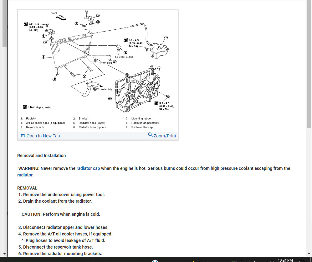

Below you will find the process from the manual that will help with replacing this. Please let us know if you have questions on this. Thanks
