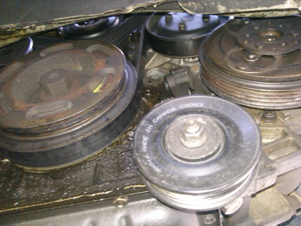

MKLING
  • 8 POSTS
I get a loud squeal when idling just below 1000 rpms. I think it is the idler pulley but I'm not sure. It sounds like a bearing metal on metal high pitched whistle.
I did read that I would have to loosen the motor mounts and jack up the engine. What is the best way to do this. I don't want to bend or crush anything.
Is this something I can do myself and any step by step instructions, diagrams, pictures would be appreciated.

RACEFAN966
  • 5,029 POSTS
Ok first are you sure that is what it making your noise? I am sure it is a bearing but it could be the alternator bearing or the tensioner bearing and so on. If you have a long screw driver or something like it use it like a stethescope and listen them by toughing it so the braket or what metal is very close to the pulley and on the alternator case and make sure were the noise is coming from. If it is the idler pulley with some help you should be able to replace it. Let me know what you find and we will go from there.

DEVILDOG25
  • 4 POSTS
The top one is fine its the bottom one that is squealing but it only does it if the a/c is on.

MKLING
  • 8 POSTS
I've listened and listened and still can't pinpoint the noise. It definitely is a bearing though. I've used a steel rod and placed it against the alternator and the a/c compressor but could not hear the squeal through it. Could it be the water pump? I couldn't get the rod in there safely. Any other ideas? Thanks for your help.

CARADIODOC
  • 34,306 POSTS
Dandy. That narrows it down a lot. It looks like there's just the idler pulley and the AC compressor. The compressor pulley should spin very easily with one finger. In the front of it you'll see that metal disc with the three bolts in it. You should be able to turn that too but it is going to turn rather hard. The important thing is it will turn with no clunking or locking up. If that happens, the compressor will have to be replaced.
Next, look at that idler pulley. That one is usually adjustable to tighten the belt, and most of the time they are not spring-loaded like the other one. They have to have something loosened to allow it to be moved, then you make the adjustment, then tighten down whatever holds it in place. On some cars that means loosening that nut in the center of the pulley, adjusting it, then retightening that nut. If that nut is loose, it will allow the bearing and pulley to tip and will cause a squeal.

RACEFAN966
  • 5,029 POSTS
Yes it could be the water pump, using the rod against your ear is the way to listen for it. Did you check all the idler and tensioner pulleys that you could get too?

MKLING
  • 8 POSTS
It is so tight on that side of the engine that I'll do the wrong thing and rip my ear off. LOL.

RACEFAN966
  • 5,029 POSTS
Well then there is only one other way to check it and that is pull it off and feel and listen to it. Sorry it took so long to get back you we are having a lot of snow here in north idaho we got another 12 inches just today now I have more then 3 feet on the ground so I have been snow blowing and such. Thanks for you patience.

MKLING
  • 8 POSTS
The squeal was the water pump. I came out one morning and there was water under the car. I went for broke and replaced it myself in about 6 hours. It's been almost a week and no leak or squeak from it.
I am now noticing a slight squeak from the alternator now. Could the belt be too tight? I have about 1/4 to 1/2 inch deflection so I don't think it is.
