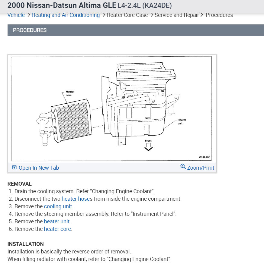

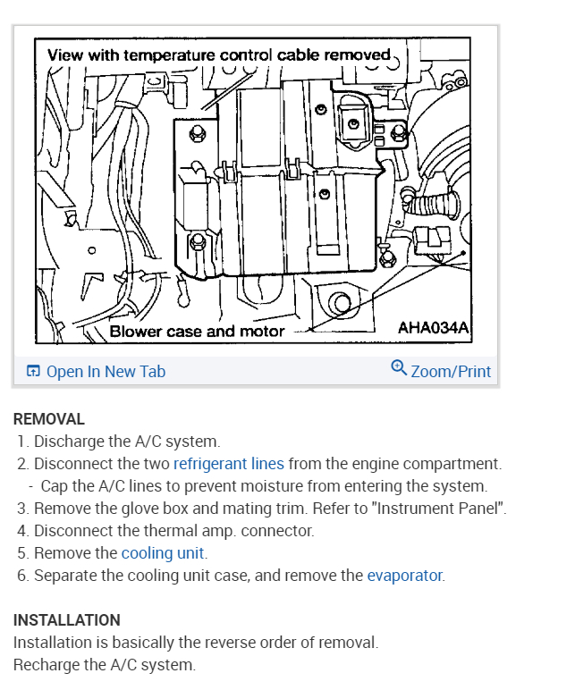

How do I replace the heater core and does the dash pad clip have to be removed? I removed the glove box door and the casing around the core, but there seems to be something holding it from the rear near the fire wall?
