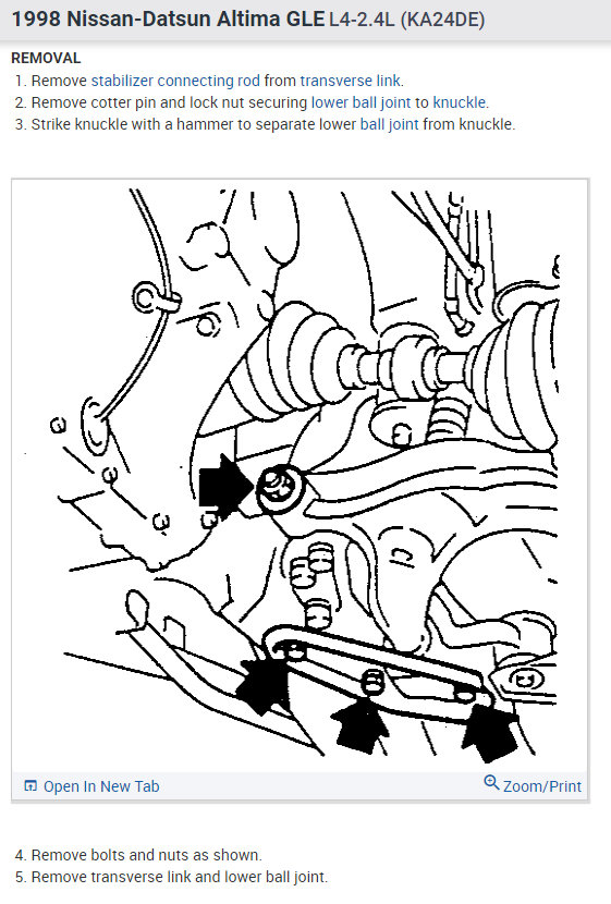

Not at all. After raising the vehicle and removing the wheel. Remove the nut to the ball joint. Remove the sway bar end link. Remove three bolts holding the control arm, and install is reverse.

In order to replace the control arm fist, you will have to lift the vehicle and support it with jack stand.
It will be easier if you remove the wheel, it will allow easier access.
Remove the stabilizer connecting rod.
Remove the ball joint nut (should have a cotter pin that will have to be removed first)
The you should bale pry the ball joint loose.
Here is a helpful article:
