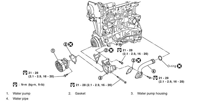

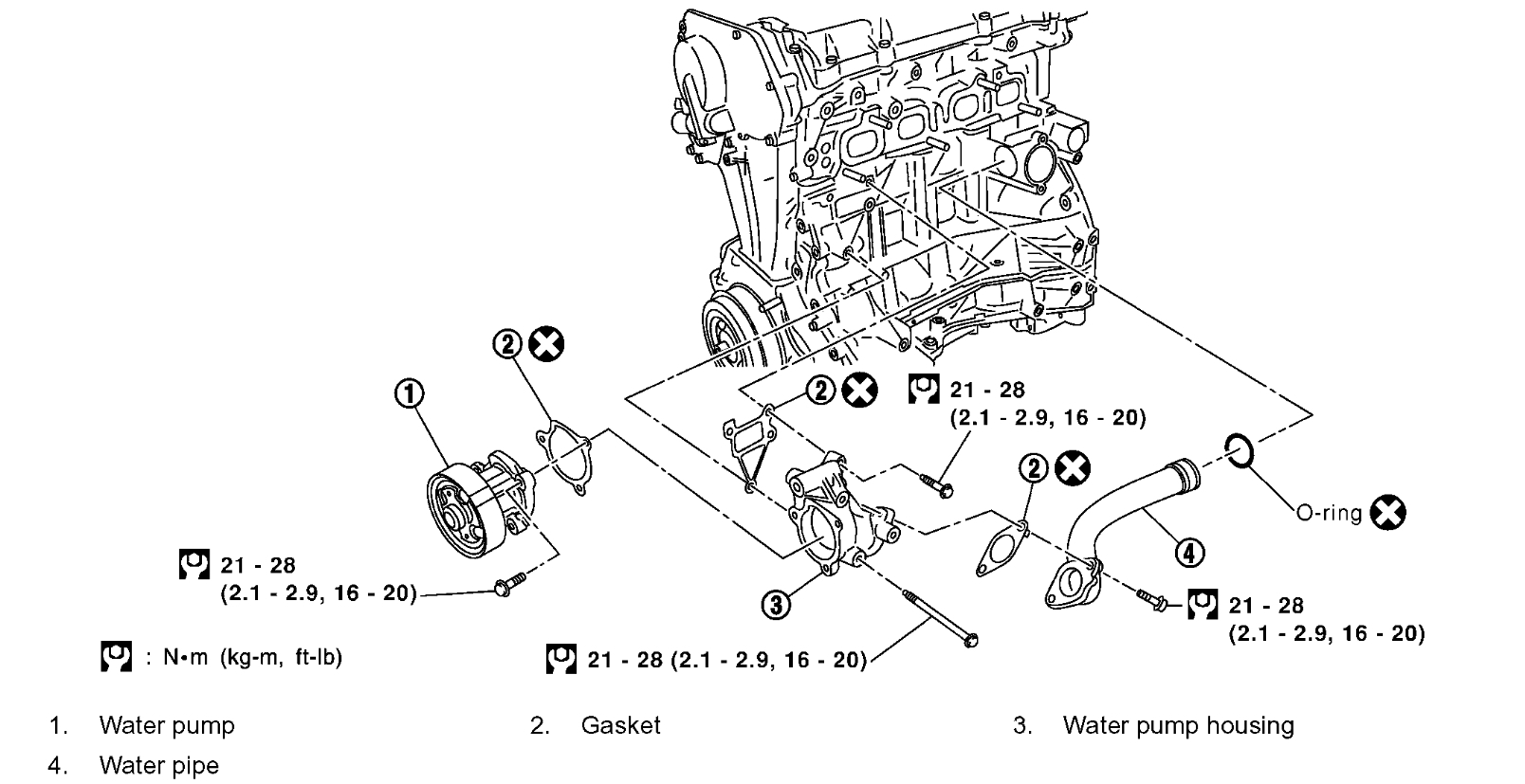

It sounds like the water pump impeller has fallen off the water pump, I would remove it to confirm the failure here are two guides to helps walk you through the repair and diagrams below to show you how the job is done on your car.
https://www.2carpros.com/articles/water-pump-replacement
and
https://www.2carpros.com/articles/engine-overheating-or-running-hot
Check out the diagrams (Below). Please let us know what you find. We are interested to see what it is.
