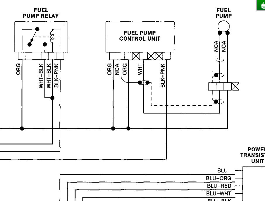

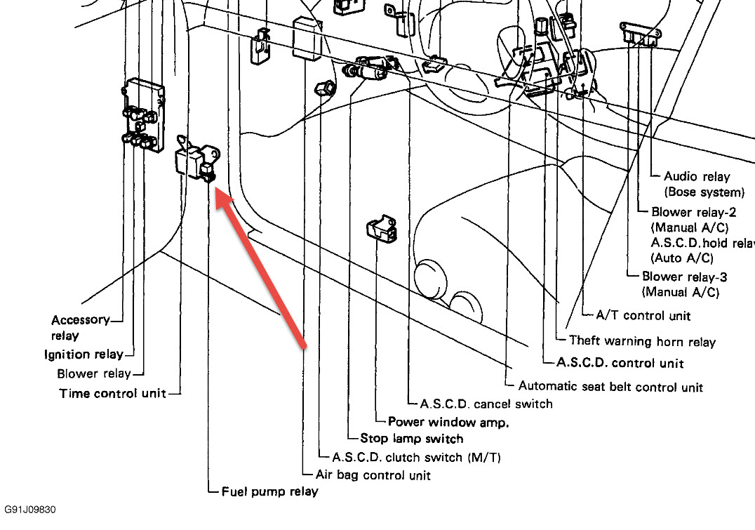

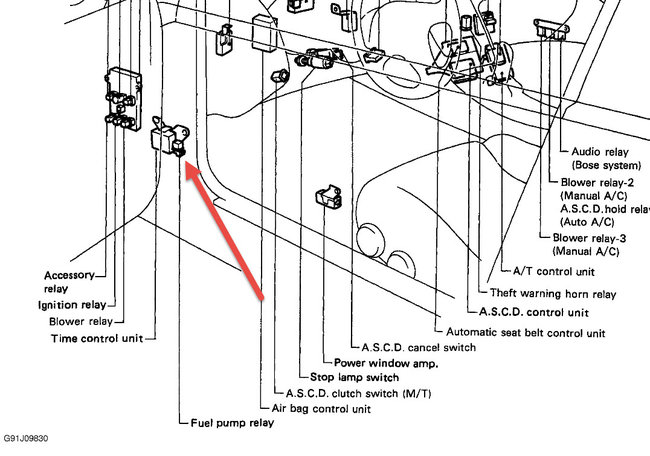

check fuel pressure with a gauge auto parts rent it. also, see if pump is getting power as most have a relay see picture, behind left kick panel. you also have a fuel pump control unit which could be bad as well which the ECM turns it on via the pink/black wire going to it. you should have forty three psi and may need an adapter because it has to be checked by fuel filter.

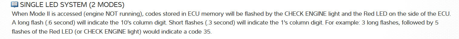

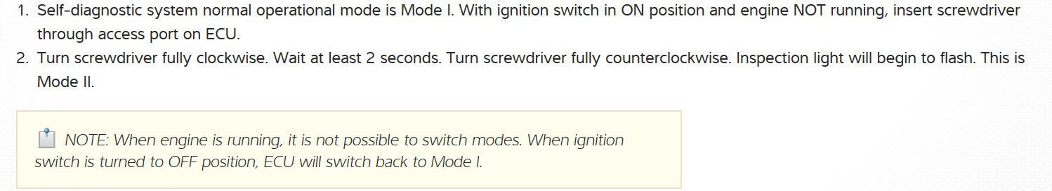

it cold be but you need to scan for codes see pics on how to do it then get back with code if any check all fuses if no ignition signal injectors will not fire so hold off on that.

I got code 55 what does that mean

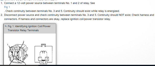

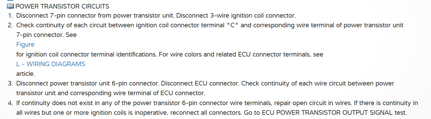

HMAC300
  • 48,601 POSTS
no faults are detected. so try this link i'm sending pics and do these tests to see if it's an ignition problem. do these in order also check resistance of coil from one post to another it should be .7 ohm

test what I showed in last reply you can still have spark but not enough to start a motor.
