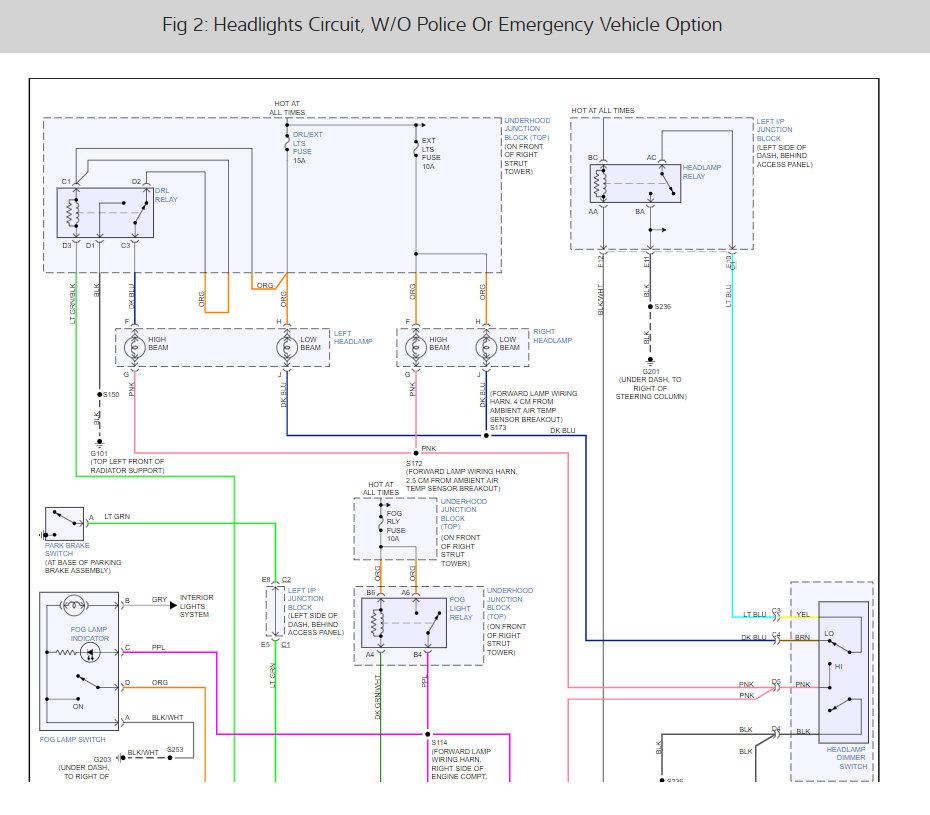

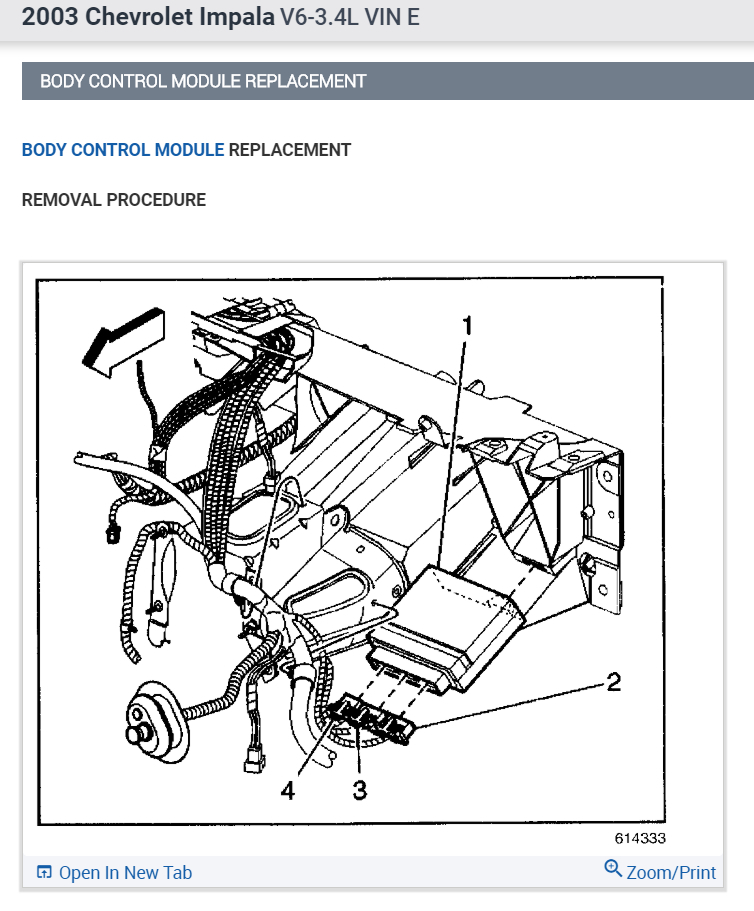

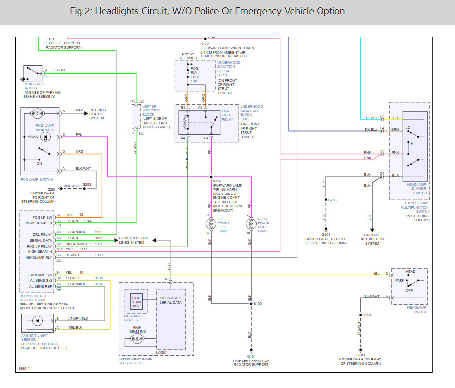

During the day all my lights work but at night time my back running lights do not and no lights in dash or radio work. they all start to work but once it completely dark they all stop. And I have checked the fuses and I can’t see it being a bulb if they work when I press on the brake.
