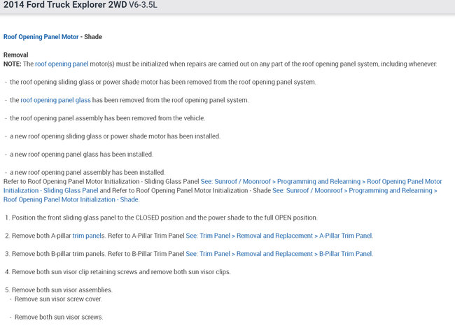

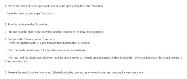

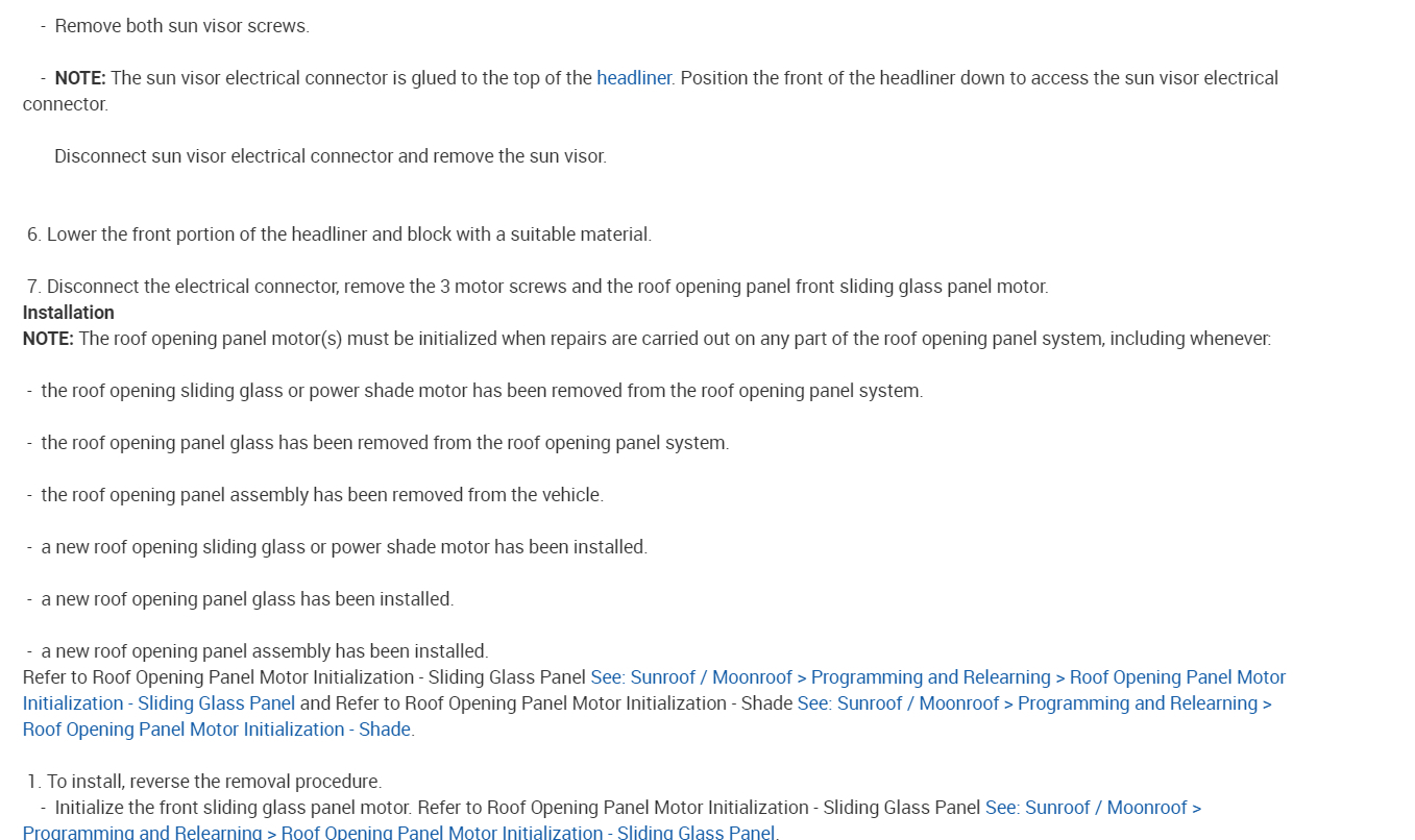

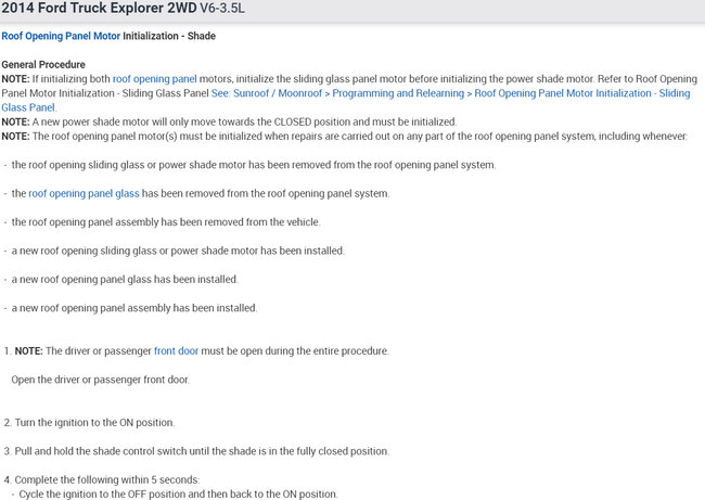

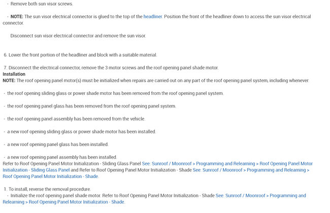

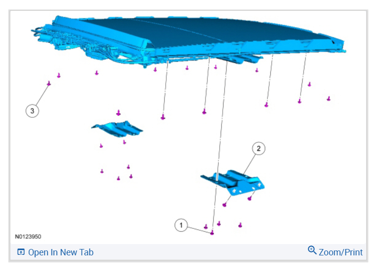

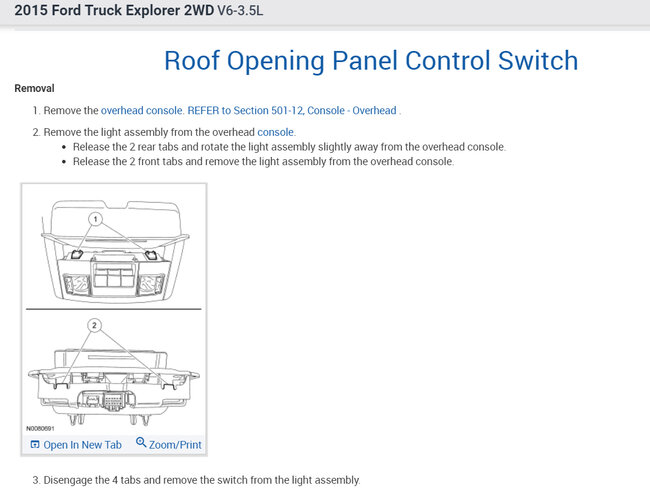

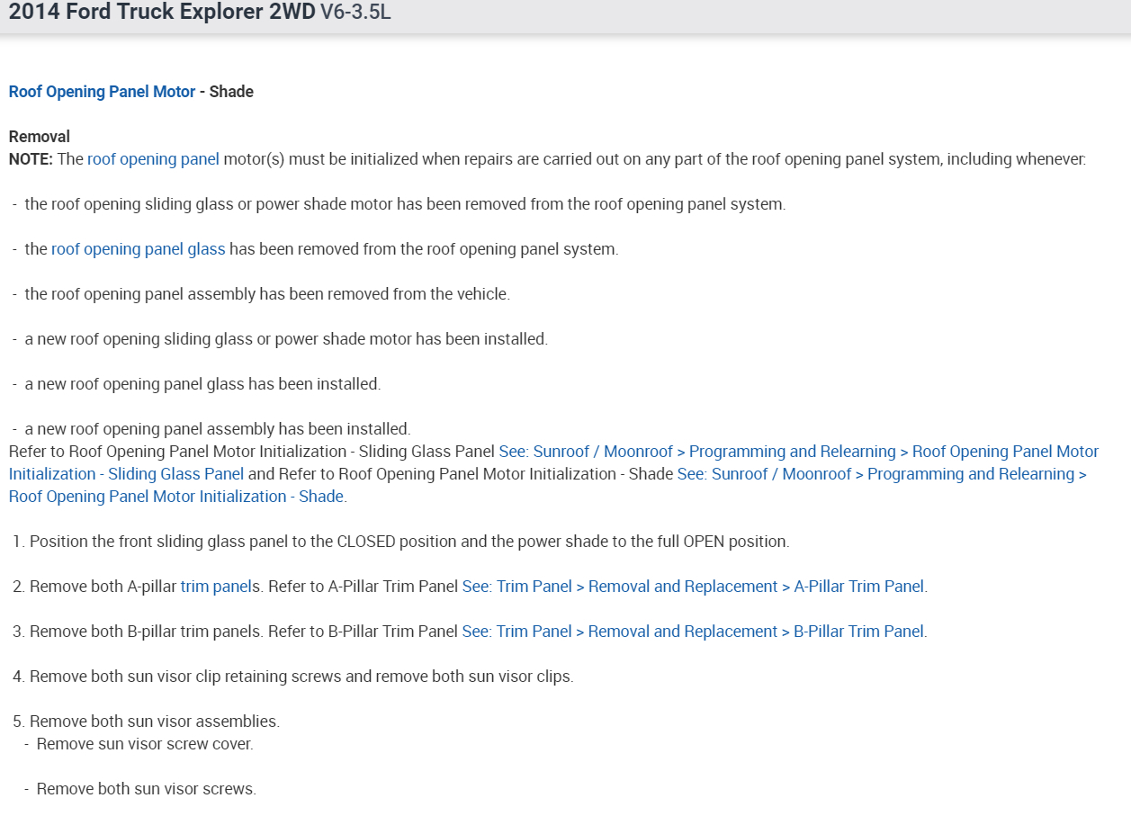

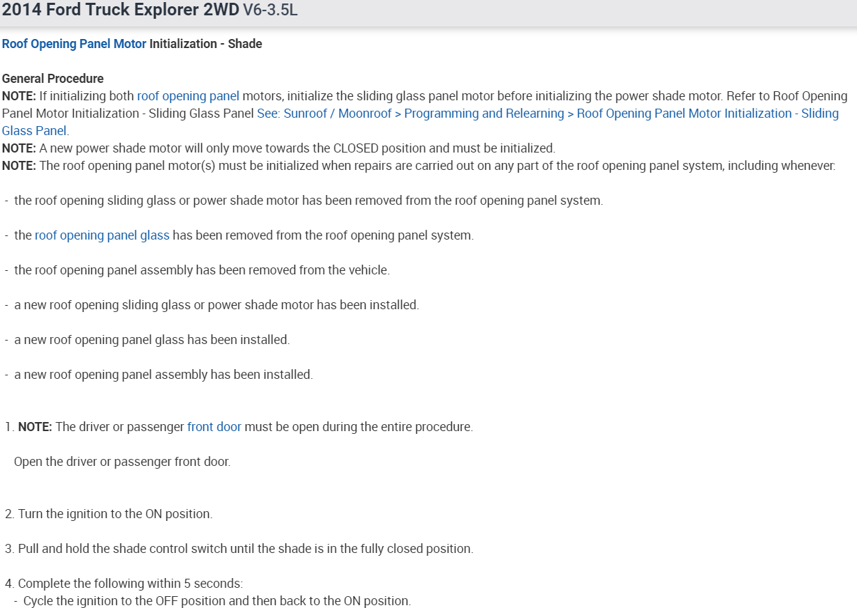

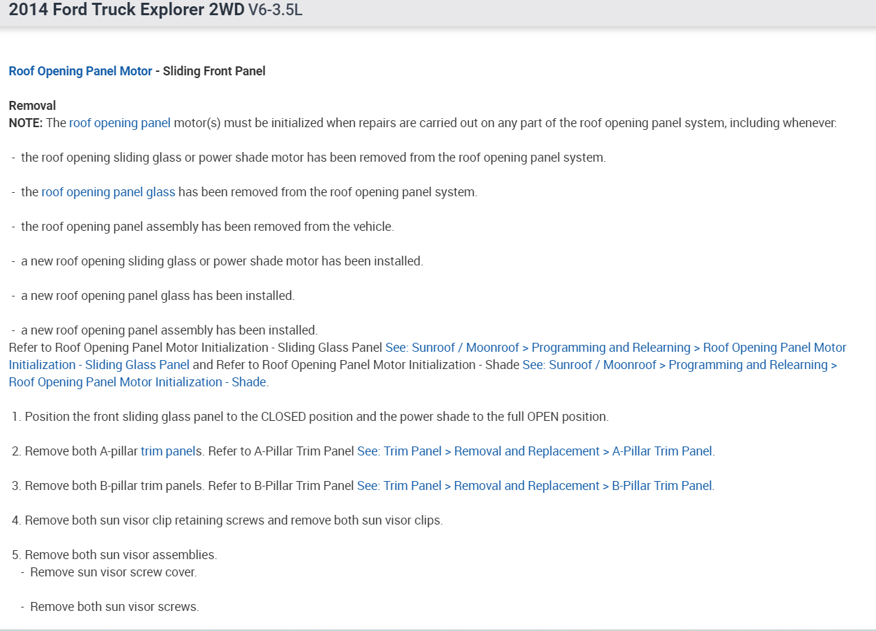

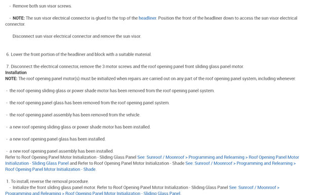

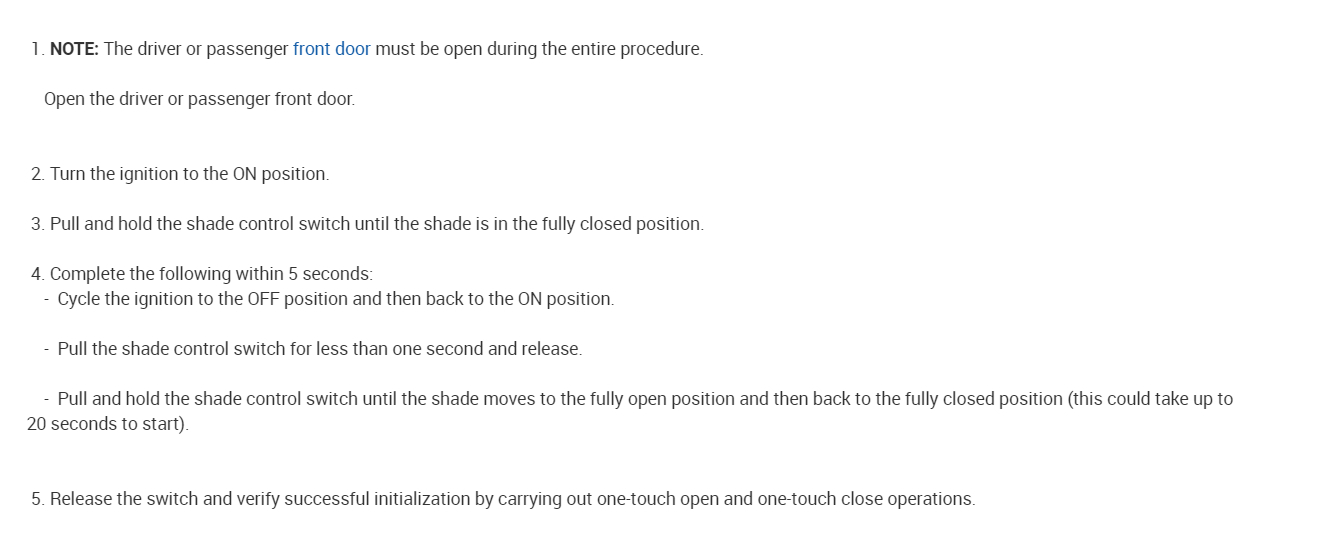

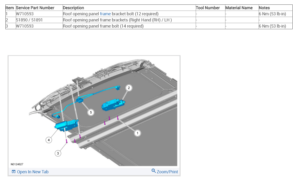

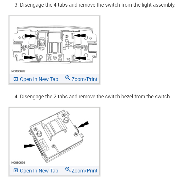

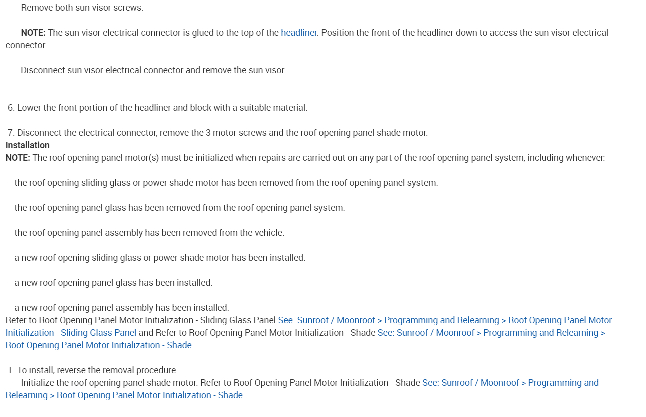

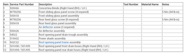

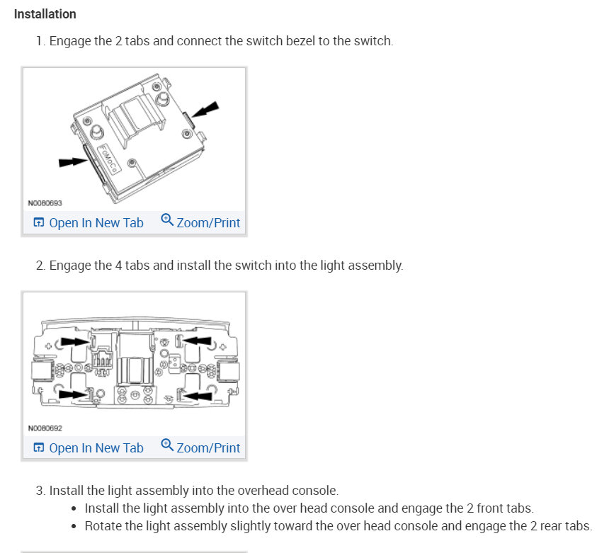

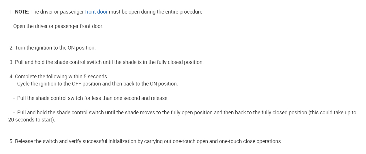

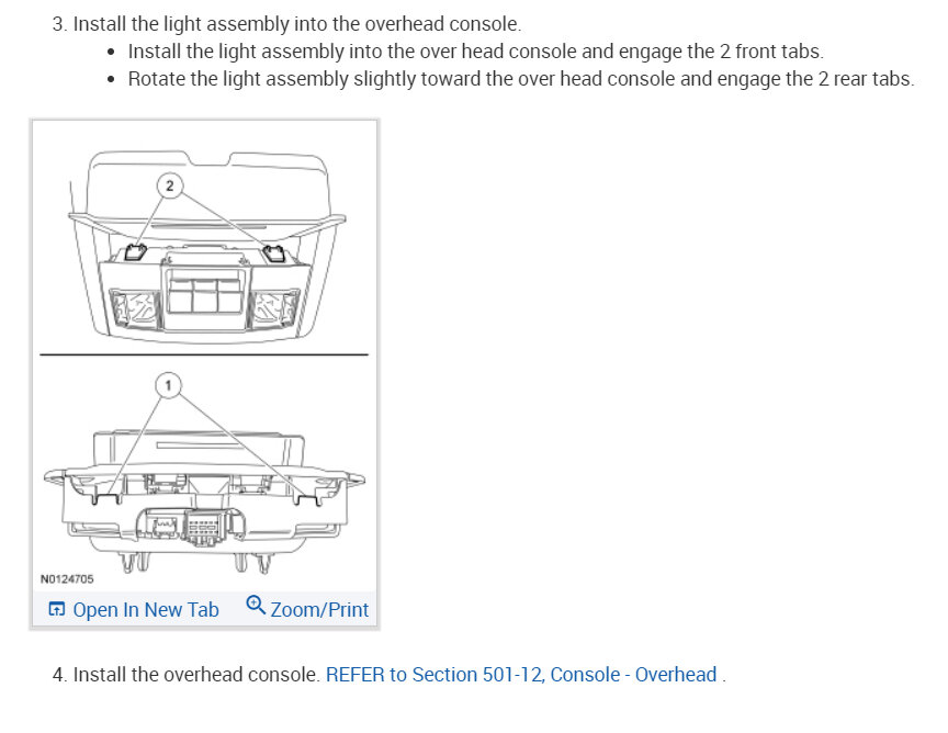

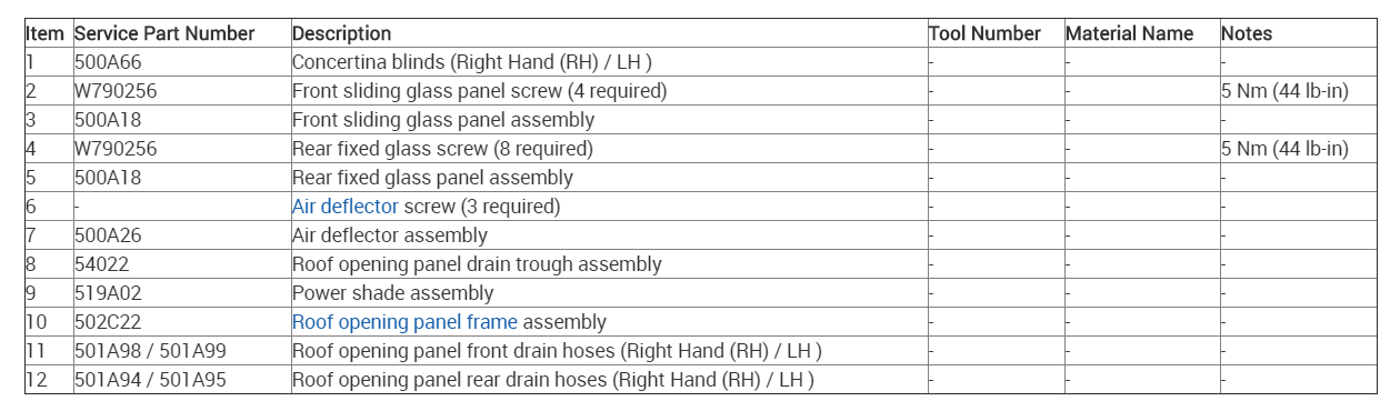

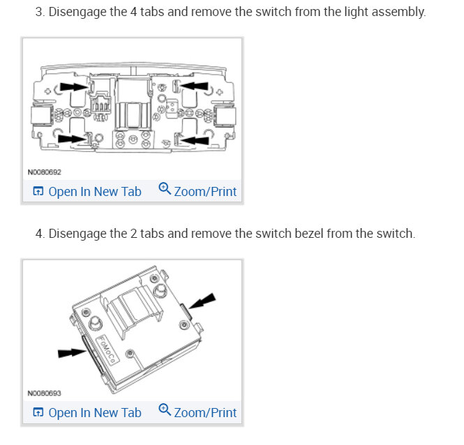

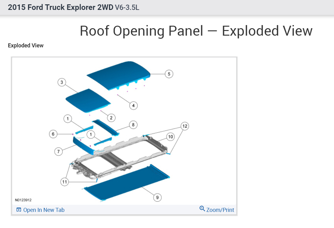

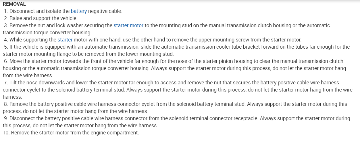

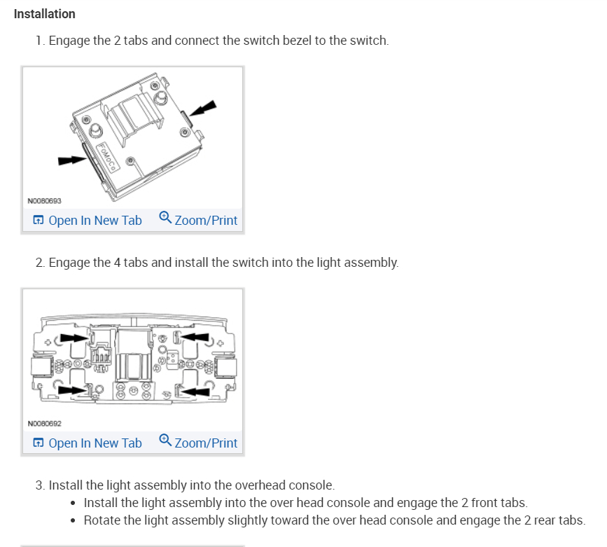

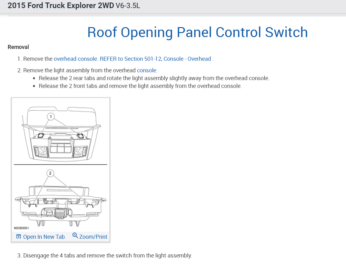

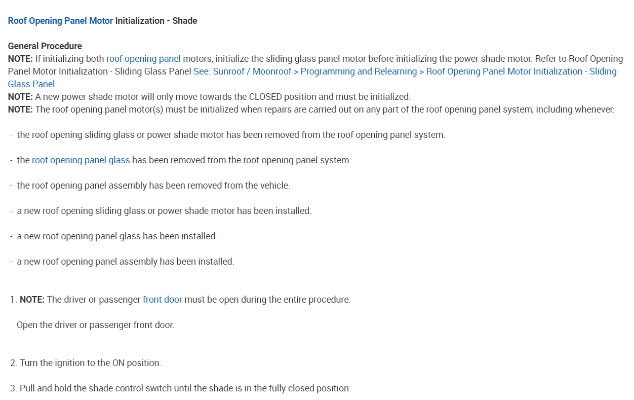

Some of these aftermarket sunroof motors don't work correctly FYI, that being said here are the instructions on how to replace the sunroof motor and program them correctly. Check out the images (below). Let us know what happens and please upload pictures or videos of the problem so we can see what's going on.
