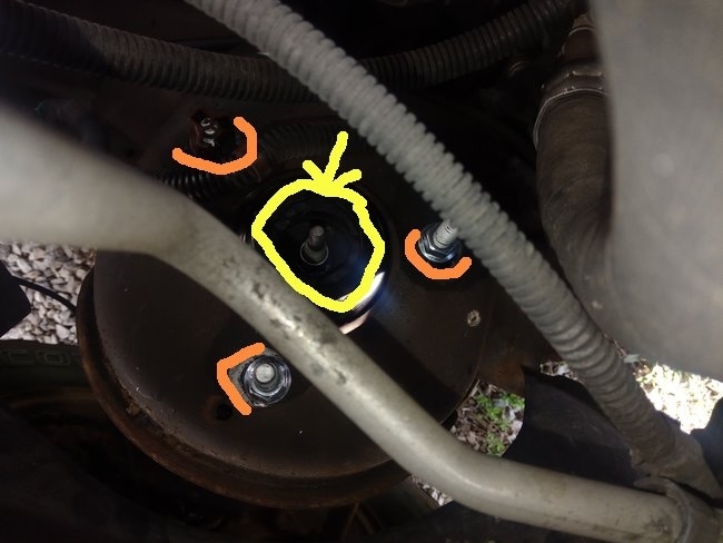

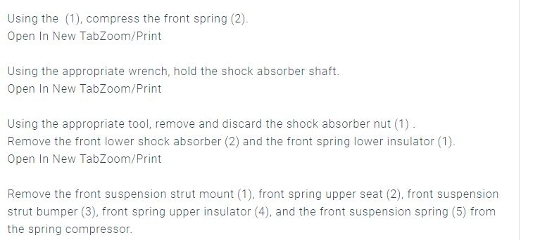

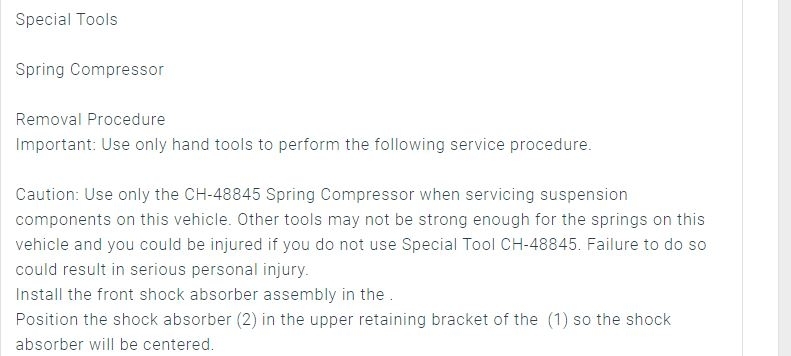

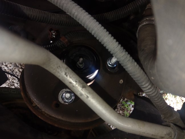

I replaced my front shocks with Duralst Shocks from AutoZone. The top three nuts do not flare out at the bottom of the nut like the old ones did. There is a small space I can see through where the upper three bolts get mounted. Should I get different nuts or put a washer in it?
Edit: Oops this is on a 2007 not a 2015. I finished this about midnight last night, after further inspection I am wrong. It appears the old shock maybe moved a bunch creating a bigger hole. Should I be worried?
