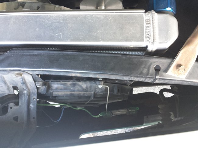

To address my radiator and it's shroud. The shroud covers the entire area of the radiator. If you look at the 1st picture you literally can't see even the width of the shroud because it's just a sheet of aluminum between the radiator and the fan. It's not a shroud that makes a whole lot of sense to me, but it's what everyone is selling. The airflow is going to be in the center and like you noted it's not going to pull from the corners and the upper left is the hot spot. If they centered the fan in the upper left maybe it would be very different. I know the car gets cooler when it moves it just doesn't get cool enough. Conceptually I shouldn't need a fan at highway speeds because the airflow should outflow any fan. The heat keeps growing degree by degree the longer I sit the more degrees build this is not like it's cold right to overheating. But the higher the outside temp the faster the process which is why I'm thinking of just removing the shroud to see what difference it makes. The whole idea of going electric was that it would cool better sitting at a light but that doesn't seem to be true and yet it should be and the other was to reduce road noise. When the car is sitting still there's very little difference in temp from top of the radiator to the bottom, maybe 10 degrees, that's not enough. I'm not losing any fluid so I'm pretty sure I don't have a block problem. The fluid is all new and all a 50/50 mixture with distilled water and like I said before I did 2 chemical flushes because the mechanics didn't flush it out before putting the radiator in. The coolant is still clear at this point you can see through the coolant with ease I see a very minor accumulation of Stop Leak but nothing like what I had seen originally. I should also mention in winter it over-cools. Intermittent heat to the inside when going over 40mph or so. That was last winter and I've have dropped in a new thermostat I don't think any of the other changes would affect that interior heat of which I get plenty in summer. Never had a clutch fan probably because of clearance problems. This was originally a small block 350 Part of what I did when I got it was to fix what they missed when they converted the car to a 454 but there have only ever been 2 size radiators and one size radiator support for either core. I have the largest the other is only slightly smaller by 2 inches in width if memory serves.
I think I covered all your questions or responses, unfortunately, it's still a long story. It's a lot to take in but each discussion gets both of us closer to being on the same page. I may tell more than I should but something I might say different might make it more obvious. My honest opinion is that it's going to come down to that fan placement and a reshaped shroud. Because the shroud can't be refitted to another fan unfortunately maybe I could make a model out of wood paneling or something cheap where I could do some other configurations, of course, the cost of the fans doesn't allow a whole lot of choices. Maybe the first trial is just to try moving that 16" up and over towards the left and at the same time pushing it as close to the engine as possible but there's not a lot of space to go that direction.
Pic 1 is the space between the back of the new fan and the front of the engine. Tiny would be the word that comes to mind. The bottom edge of that picture would be the sheet of aluminum.

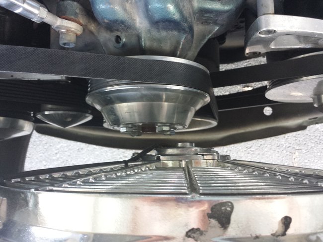

Pic 2 Passenger's side of the radiator you can see the condenser starts here, you can see the radiator itself and the support.

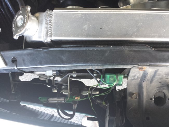

Pic 3 Driver's side of the radiator you can see the disconnected secondary sitting in front of the condenser which I had said I might be able to put 2 pushers in between the condenser and the radiator and may have better results.
