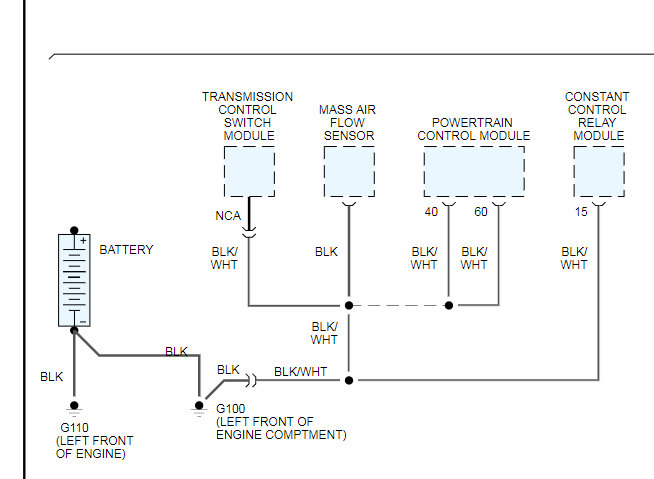

I just replaced the negative battery terminal on this car and now i get in turn the key to on and everything appears normal, but when i try to turn it to start i hear a quick click and then all power is gone like the battery instantly drains or shuts off the power to the whole car. the car ran fine before i replaced the terminal. How do i fix this to make car start up? on the negative side of battery it has the normal thick wire, but then there is also a smaller wire from the terminal to what appears to be a possible body ground. Please help.

Couple things. First did you compare the old cable to the new one and make sure they are the same? I attached the diagram of the battery ground so we need to make sure each is connected. This sounds like we have a relay issue but if we can verify the connections at the G110 and G100 and then go from there. Thanks

Thank you... This helped and also the positive terminal was gunked up that it was causing the issue.
