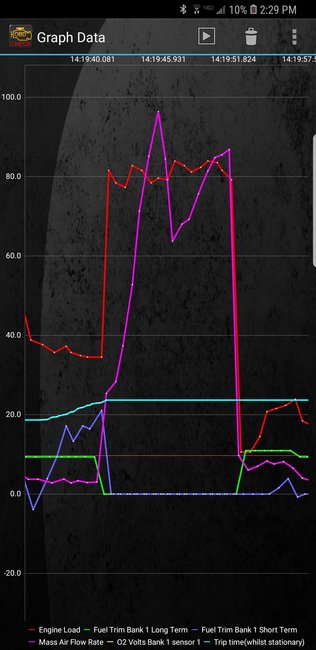

The car had broken down when the MAF sensor stopped working entirely and stopped running. I got a new MAF and it was giving me a lean code but also running rich. So I took it back and got another and the same thing happened again. So I changed the 02 sensor twice as well thinking that part was bad twice smoked out the entire system and sprayed carburetor cleaner no vacuum leak. A/F ratio is reading 9.5:1. Did a test run 0-60 on my diagnostic tool and recognized a weird fuel trim pattern as if I have a vacuum leak but I do not break booster works fine no issues.

This is the result of the test.

Just replaced the MAF again they were giving me the wrong part. It is running better no drop in rpm's when I turn on the A/C the a/f went to 11:1. I will pull the plugs today and send pictures they are a couple months old plugs three prong I think they might need gaped. It tends to run more rich on throttle according to my scanner going to check the air filter too seems restricted should be getting 2g/s only getting 1.8 according to MAF. Sounds like it may have a light misfire it is not as noticeable as if you were to pull the o2 but it definitely has one.
