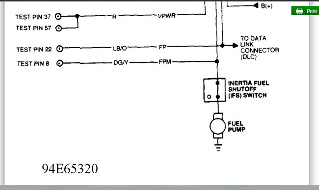

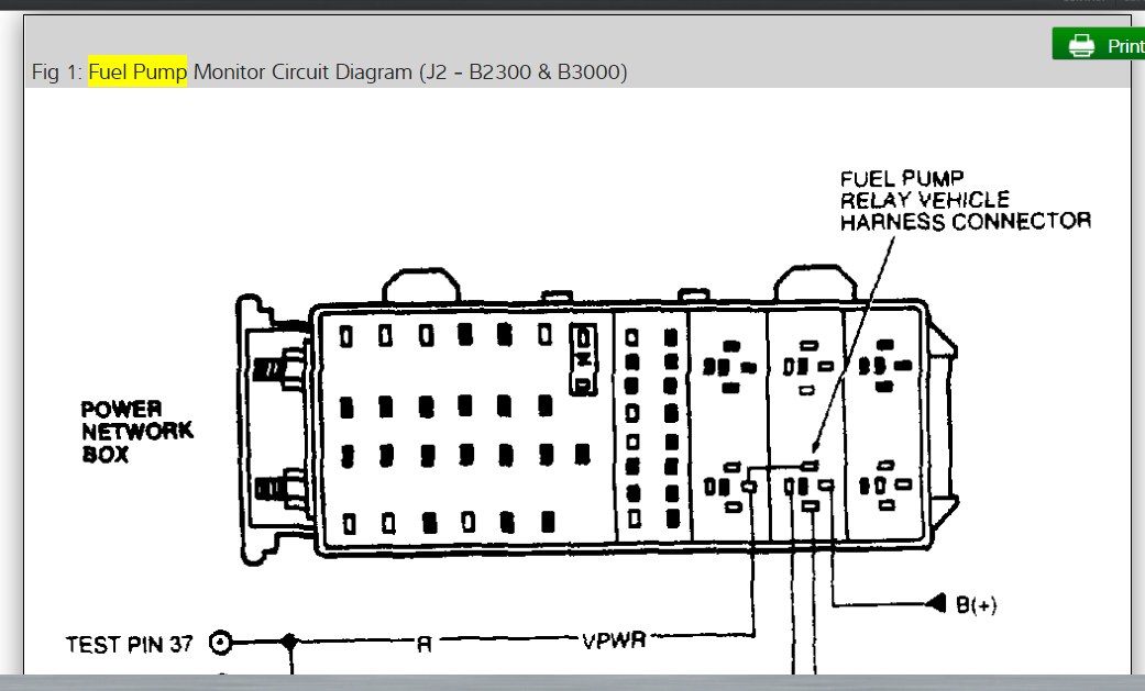

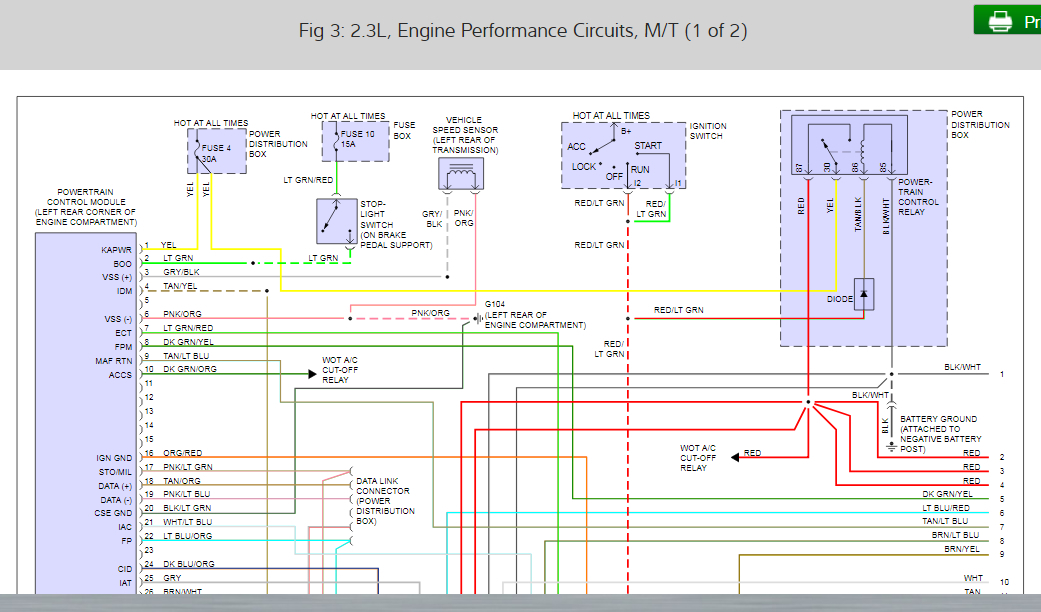

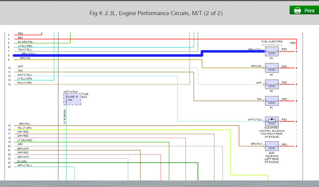

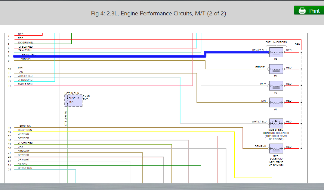

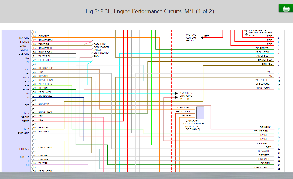

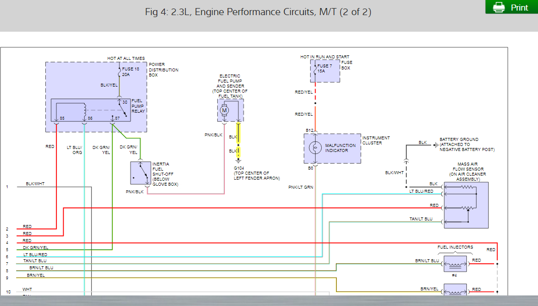

Shut off while going up a hill, truck started sputtering almost as if it was out of gas then lost engine power. a few seconds later, i started it and limped home. Now it wont start at all, cranks, just no start. I figured it was the fuel pump because i couldn't hear it running. so i removed the bed, replaced the pump and filter. still nothing. I replaced the EEC and fuel pump relay. still nothing. i also checked the inertia switch and it hasn't been triggered. The truck will start with starting fluid into the intake, then shut off. I have power at the pump 4 pin connector and at the relay.
Any help would be great.
