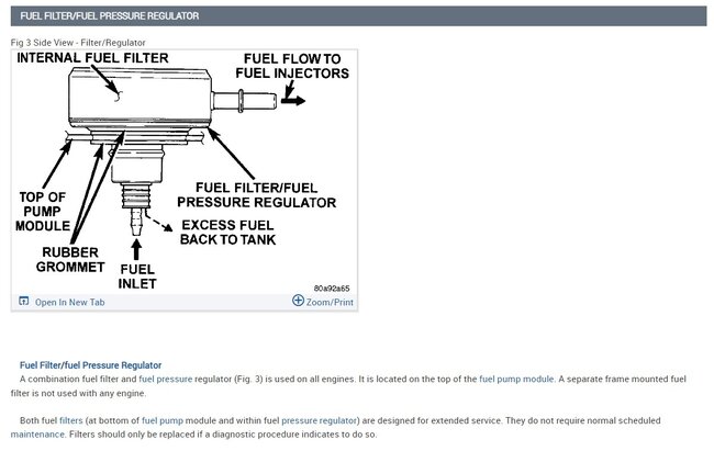

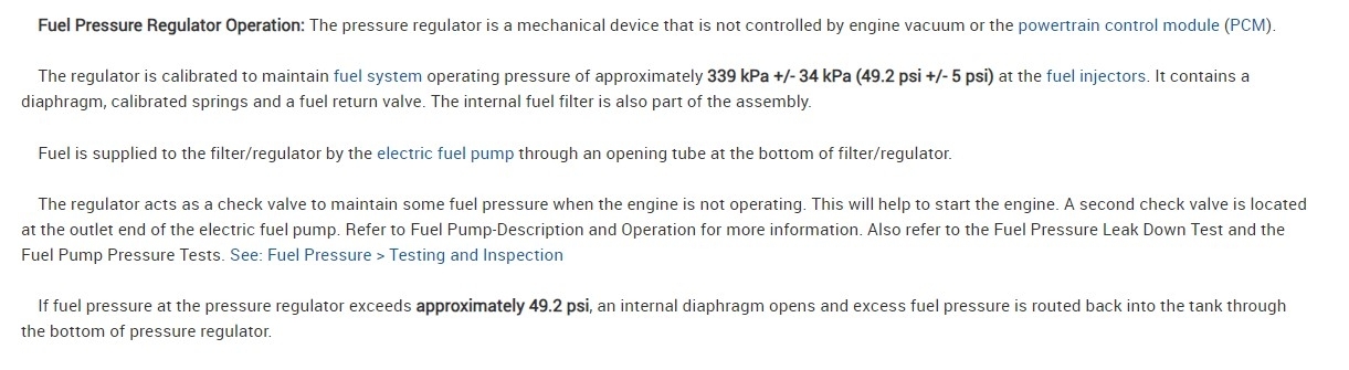

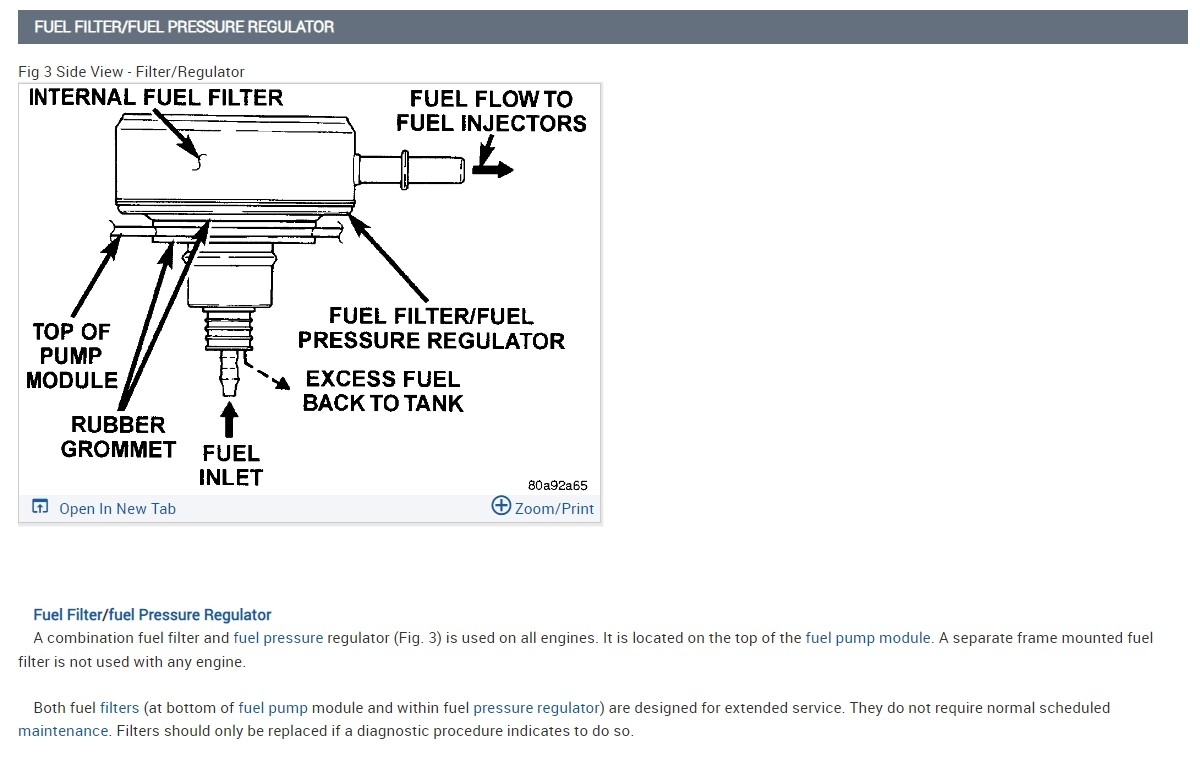

Okay, so it will only run for a few seconds then stall out. You don't see any security light flashing or staying on, in the instrument cluster, do you? You also mentioned you replaced the fuel pump as well; did you happen to replace this fuel pressure regulator (diagram 1) it has an internal fuel filter in it. The fuel pressure spec is 49psi, so if the vehicle is starting and stalling, it can be a security system issue or a lack of fuel volume/pressure.
Also does this vehicle have manual or electric door locks? If it has electronic door locks, then it has an Anti-theft system. And if the battery has been disconnected on this security system, once the battery is reconnected the system goes active, if I remember correctly, the security light will flash or stay on for 2 seconds at key on then go out when cranking. But you would notice the light staying on if the system is preventing starting. If the light is on, you could try locking the vehicle and then unlocking it, that should disable any security system if it has one.
If it's not a security issue, you may want to T into the fuel line where you can and make sure pressure is not dropping off.

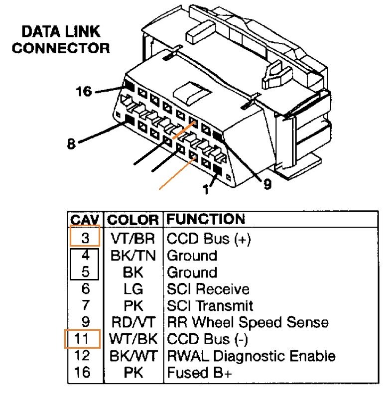

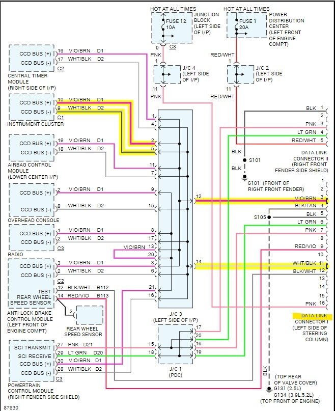

And how was the vehicle acting with the old PCM installed? Was that causing the stalling or crank no start condition? As for the Odometer flashing, I believe on the pre 2000 models, that means a data bus issue, I've been helping with a 2000 Dodge ram, the last week or so and it was flashing a No Bus message instead, I assume the Odometer is not reading any mileage?
That may not be related to the cylinder misfires you're feeling. Is the instrument cluster working? For some reason there are a lot of these exact Dakota's doing this, you can check the voltage level on pins 3 and 11 of the data link connector, pins 4 and 5 are grounds. You should only read about 2.5volts on either pin 3 or 11, those are the CCD data bus pins, 3 is CCD + and 11 CCD -.
The security light coming back on might be why the odometer is flashing, since the security system (Central Timer Module) is on the CCD network, so you may be dealing with 2 different issues which is common on older vehicles like this.

Here are a few guides to help with cylinder misfires, and the diagrams below are for checking the Data link connector voltage levels on the vehicles network:
