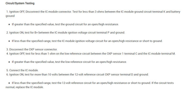

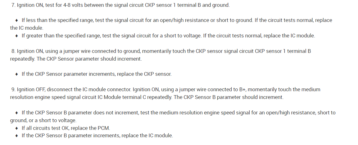

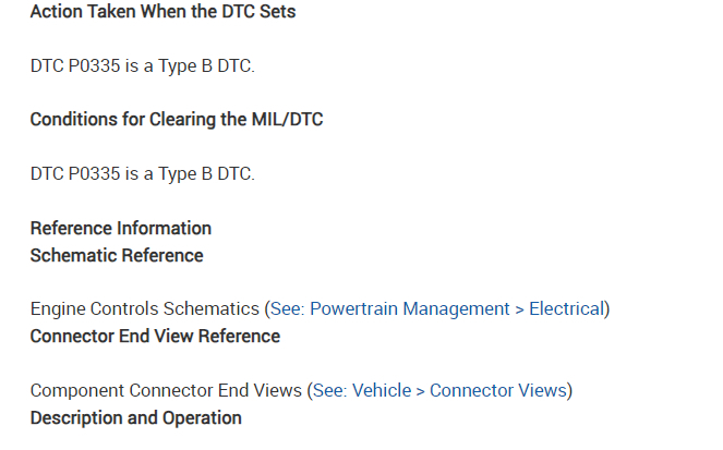

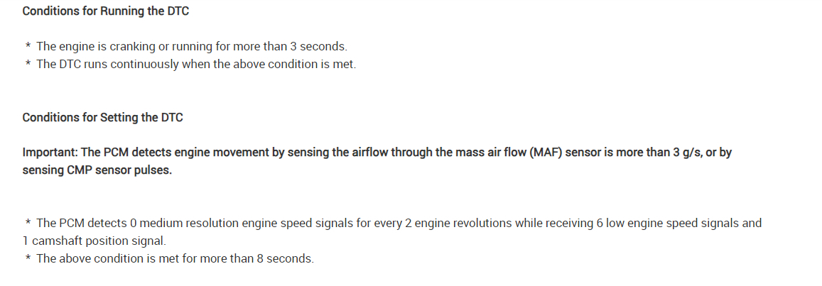

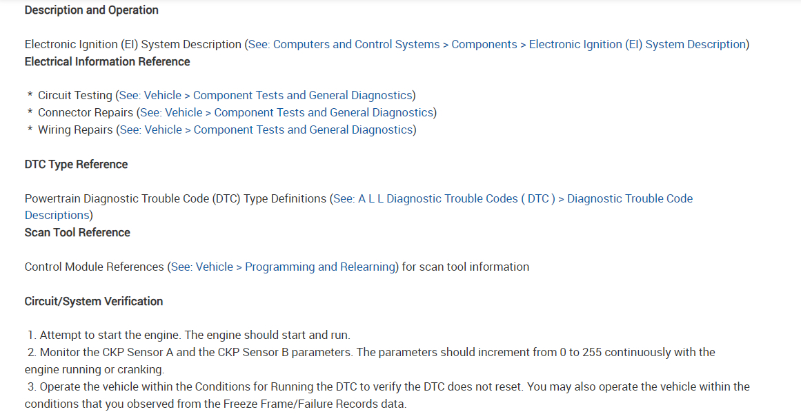

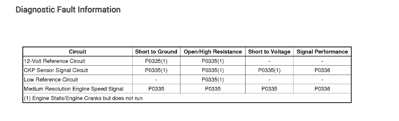

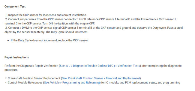

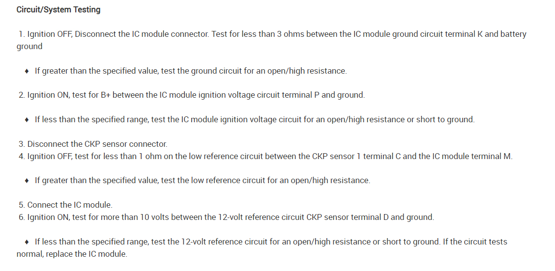

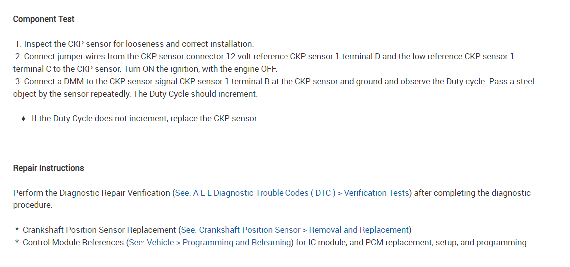

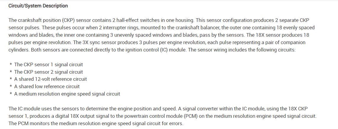

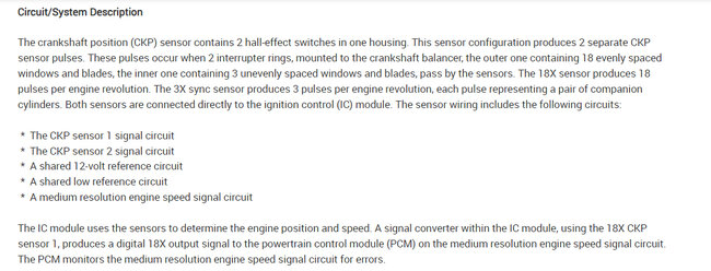

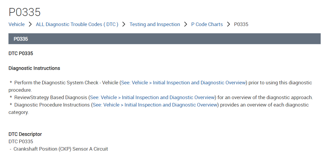

The two codes you have are related, as you mentioned. I feel the 136 is a result of the 135 code. I attached diagnostics below. Take a look through them and let me know if you are comfortable performing them.
See pics below.
