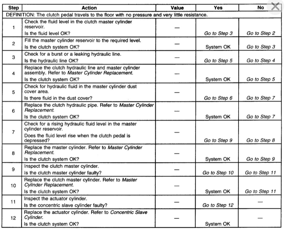

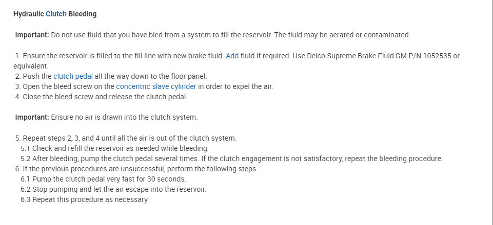

So, I am attaching the directions below on how to bleed the clutch but if there is no grinding and it will go in gear normally it doesn't have air in it.

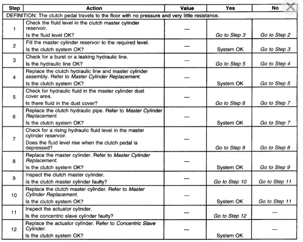

However, if the clutch is not engaging then technically you have excessive pedal travel so I am attaching the info on what can cause this.
Please run through this info and let us know what you find with it, and we can go from there.
