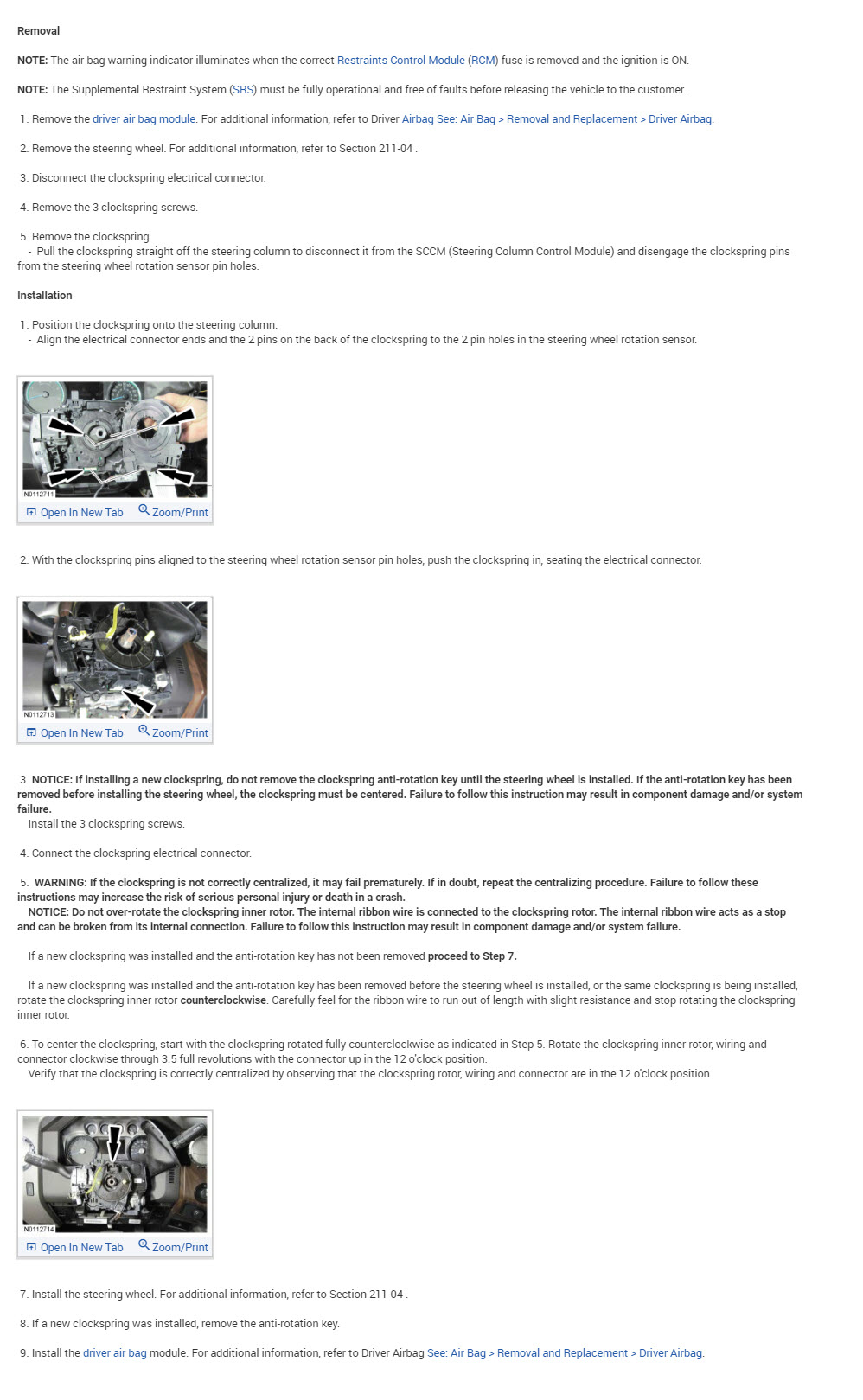

After having mechanic install clock spring the SRS,versa trac,and trailer brake module fault warning lights appear. They did not before installation of clock spring. Do i need to get BCM reprogrammed?
