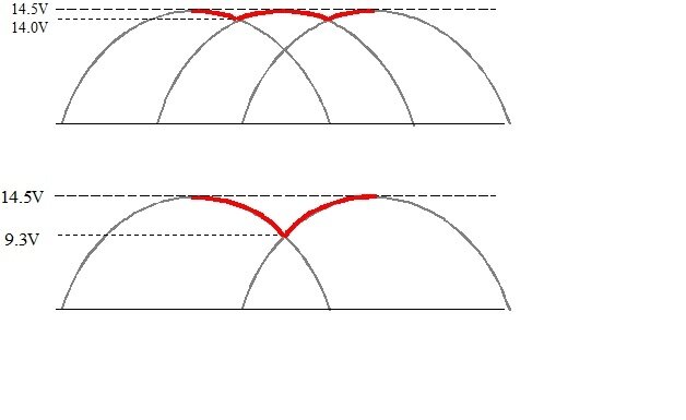

In my sad drawings below, the top graph shows normal voltage, and therefore current output. The three gray curved lines represent the voltage developed by the three circuits, or phases, in the generator. The red line on top is what you would see at the generator's output stud, and at the battery. The difference between 14.0 and 14.5 volts is the ripple voltage, which here is very low.
In the lower drawing, one of the three phases is missing. Ripple voltage is 5.2 volts which is very high. That's our clue that a diode has failed.
