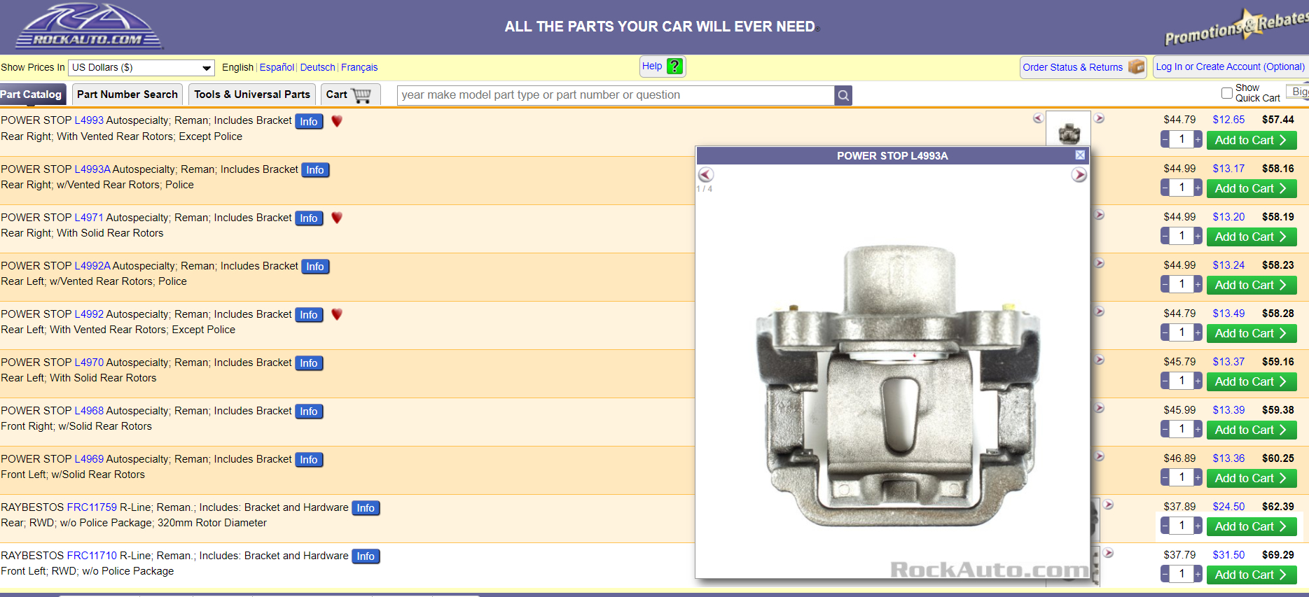

They offer both single piston and dual piston calipers for your car.
The duals were an option based on the brake system itself. The most common are the single piston units. When you have the 5.7, that would definitely have the 4 piston style.

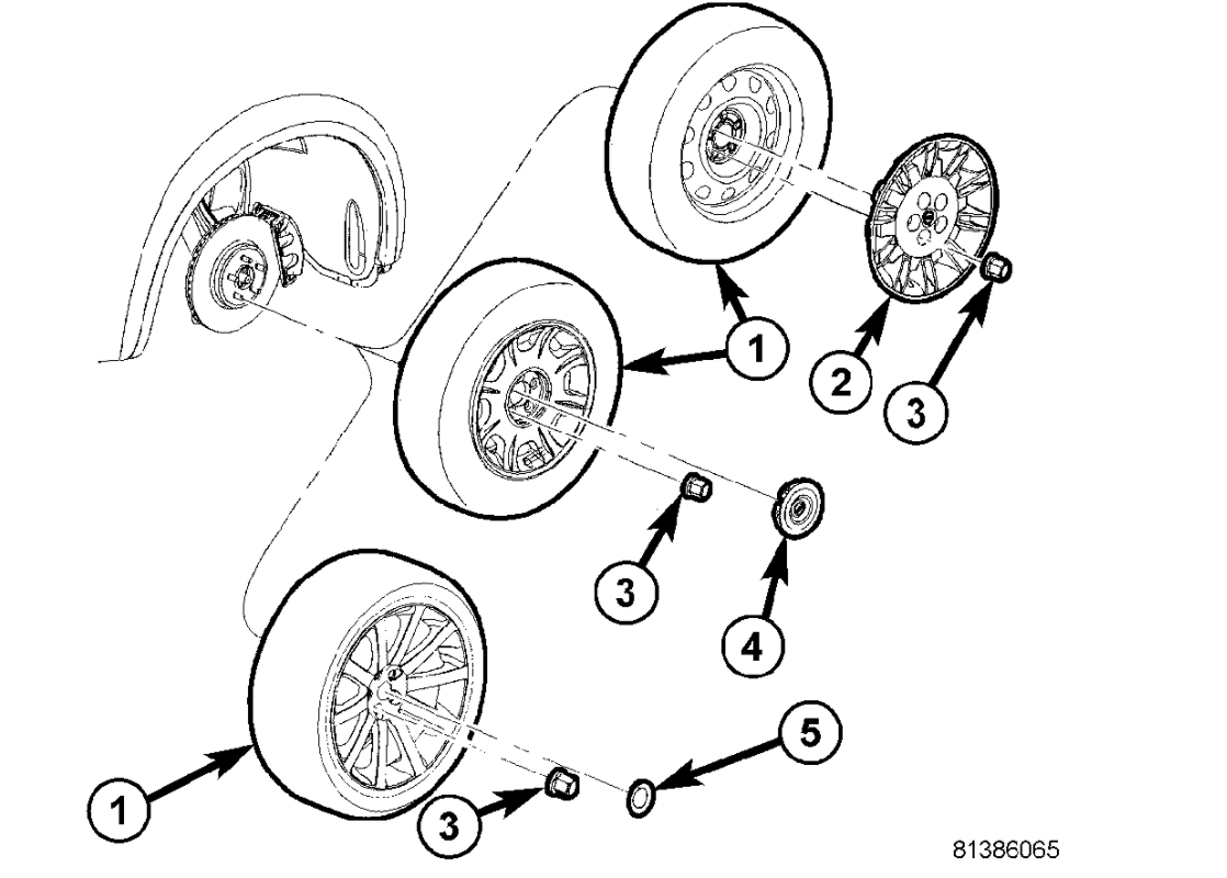

4. Remove wheel mounting nuts (3), then tire and wheel assembly (1).

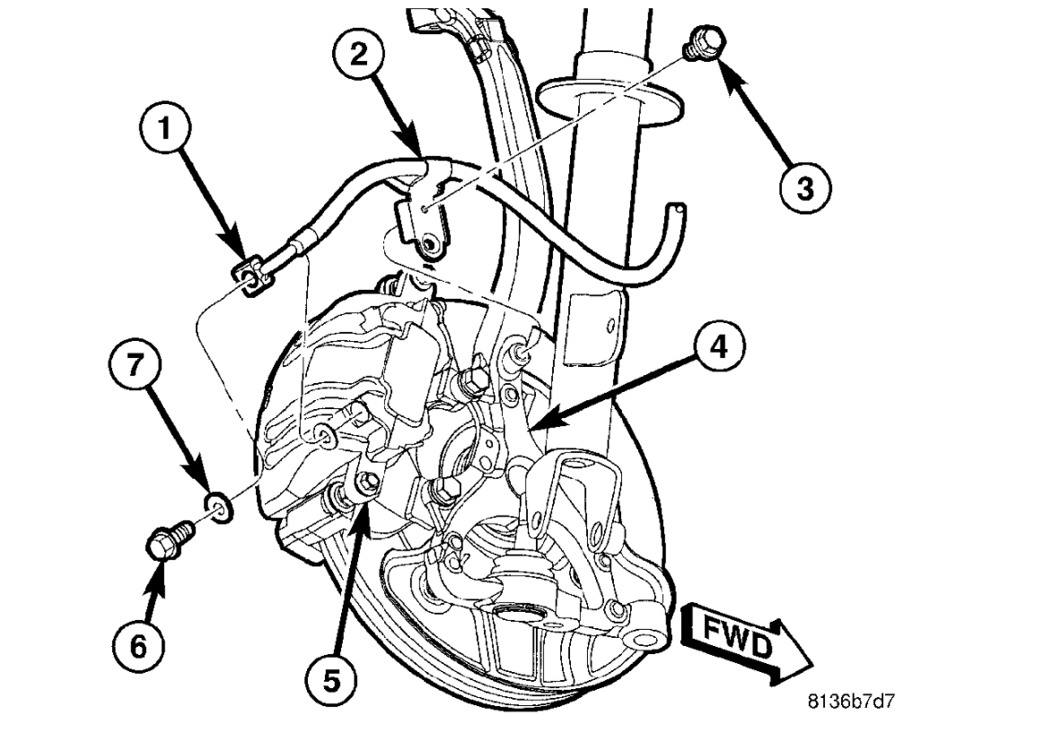

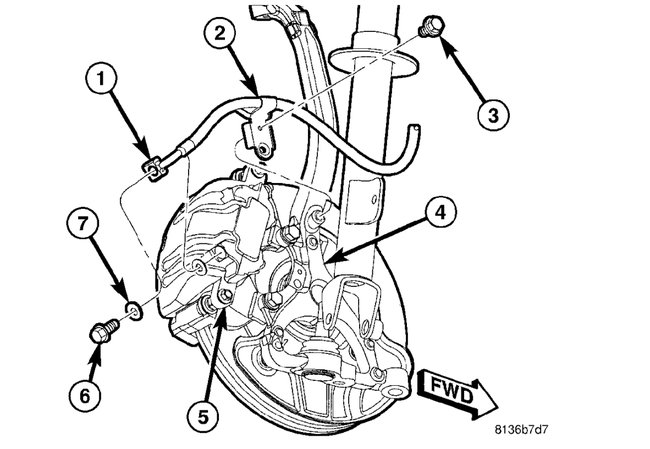

5. Remove banjo bolt (6) connecting flexible brake hose (1) to caliper (5). There are two sealing washers (7) (one each side of hose fitting) that will come off when bolt is removed. Discard these washers; install NEW washers on installation.

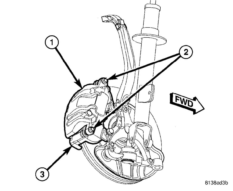

6. While holding guide pins from turning, remove caliper guide pin bolts (2).
7. Remove brake caliper (1) from brake adapter (3) and pads.

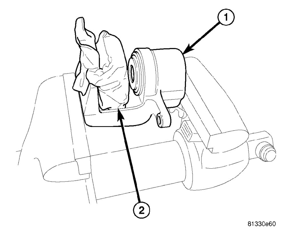

NOTE: Before disassembling brake caliper, clean and inspect it.
WARNING: Under no condition should high pressure air ever be used to remove a piston from a caliper bore. Personal injury could result from such a practice.
