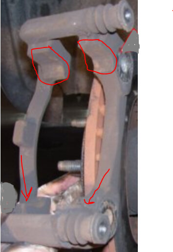

Remove the caliper, pads that seem tight, and the hardware from the mount. Take a file and clean all corrosion off the mount where the pad will ultimately be seated. Once that is clean, I always put a thin coat of brake lube on the steel mount before installing the hardware. It slows the rusting process which will ultimately press against the hardware causing the brake pad to stick.
I attached a pic below showing the locations I'm referring to. Make sure the areas I indicated are clean and free of rust and corrosion.
I hope this helps.
See pic below.
