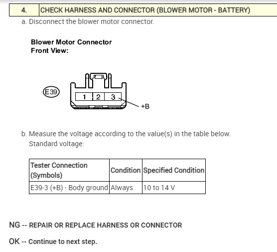

Based on what you described, we likely have a faulty connector or a wiring harness issue. I don't know how comfortable you are performing a few tests, but I attached them below.
On the connector at the blower motor, there is a three-pin connector. One pin is battery voltage, one is ground, and one controls the blower speed.

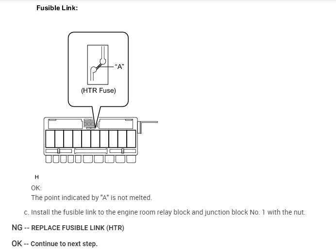

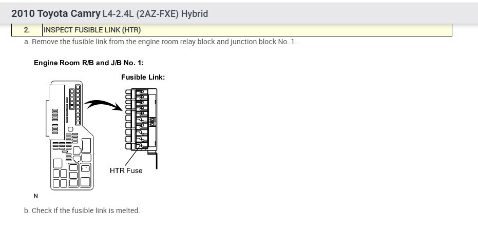

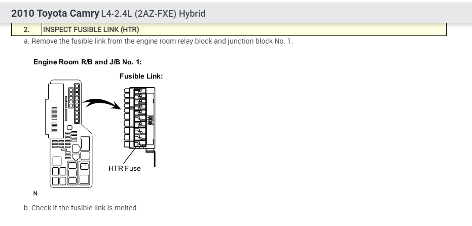

If the fan isn't working at all now, we need to first check a fusible link in the under-hood fuse box. When you check this, in addition to confirming the fuse is good, also check to make sure there is power to and from it.

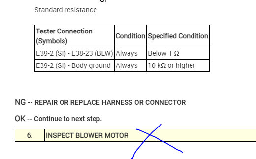

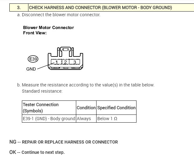

If that is working properly, we need to disconnect the blower motor. Pin 1 in the connector (see pics below) should have continuity to ground.

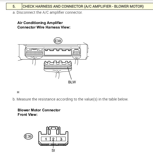

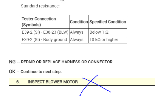

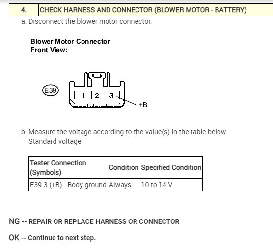

If that is good, check pin 3 for battery voltage. If that is good, we need to check the resistance at the ac manifold. (See pic below).
Here is a link that may help you:
Let me know if this is something you feel comfortable doing. The idea that you were able to hit the glove box and it worked leads me to think we have a weak connection at some point.
Take care and stay cool.
joe
See pics below.
