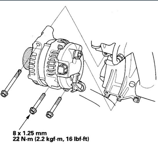

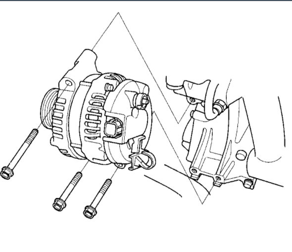

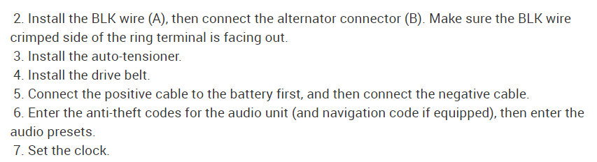

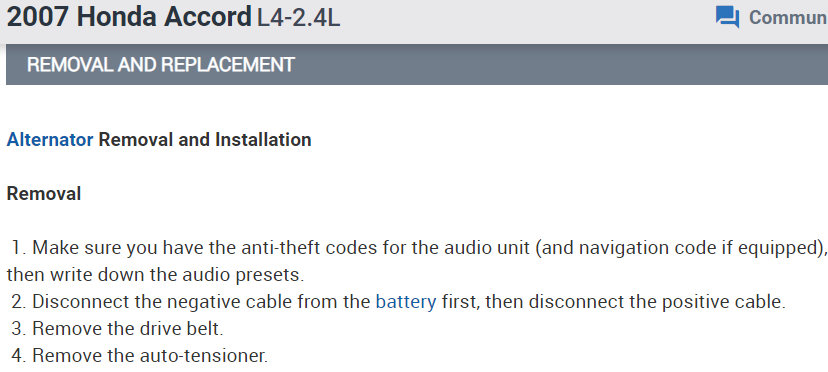

Hello, I'm Danny.
It's possible your battery might be the problem at all. It's possible the alternator his weak or failing and won't keep the battery charged. I would suggest having the alternator tested to see what its output measures. All auto parts stores will test an alternator for free. Here is a tutorial showing what is involved for alternator testing, removal and replacement:
https://www.2carpros.com/articles/how-to-replace-an-alternator

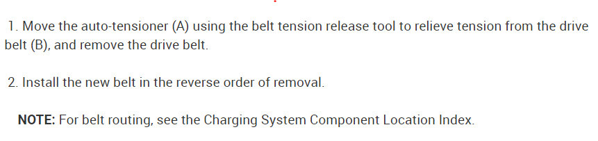

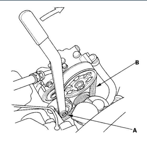

You will have to remove the serpentine belt to get the alternator off so here is a tutorial showing how to remove a serpentine belt as well:
https://www.2carpros.com/articles/replace-serpentine-belt

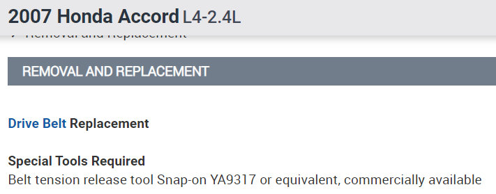

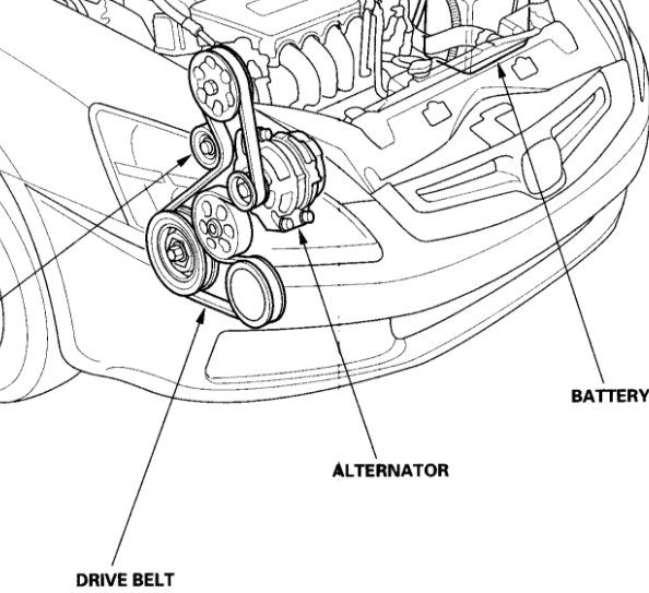

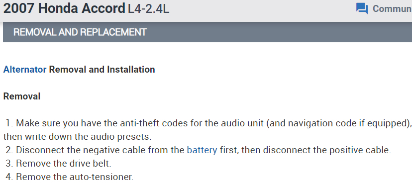

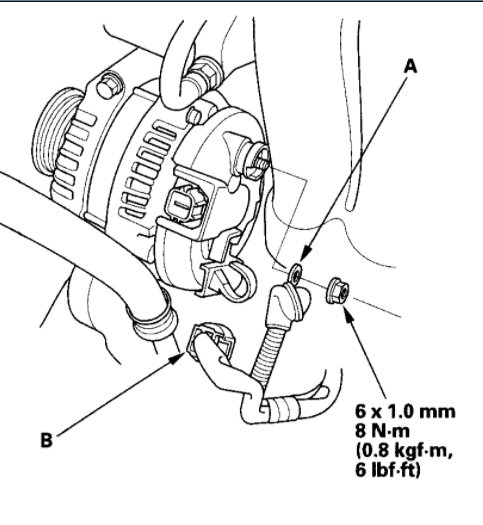

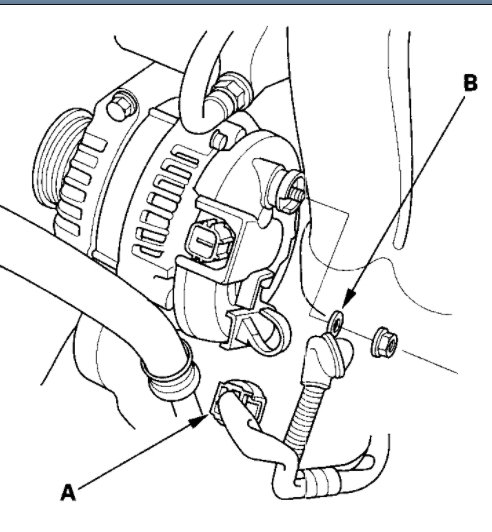

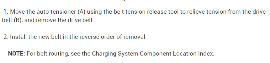

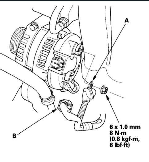

I've attached pictures steps below on how to remove and replace the alternator on your car and also included how to remove the belt as well. The last picture shows the belt routing in case you forgot after removal. You didn't specify what engine size you have so these steps are for the 4 cylinder. Let us know what you find out after having this done and we'll go from there. Hope this helps and thanks for using 2CarPros.
