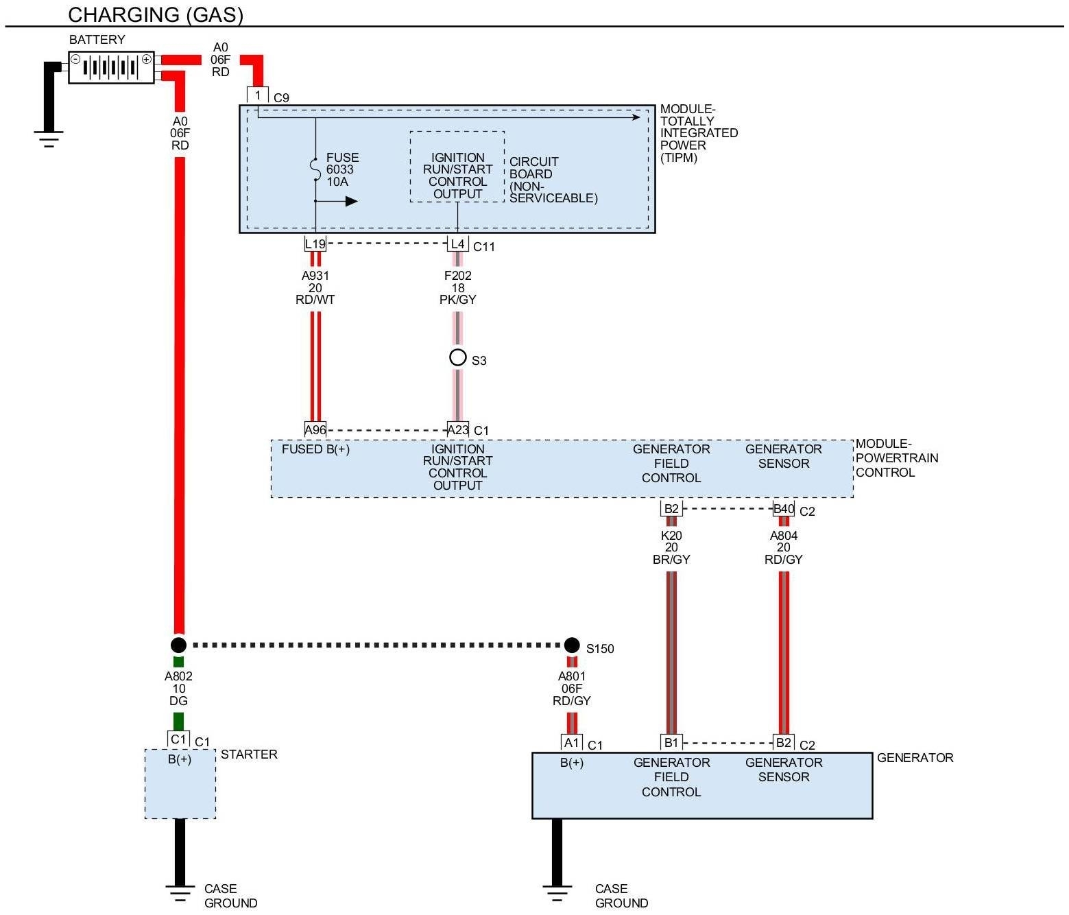

50/50, it depends on what was on or came on at the time the battery was connected.
The light itself is simple. One side goes to the regulator and connects to it's feed from the alternator. The other side goes to the alternator and reads what voltage it is putting out. The light will come on with the bulb check and go out when the alternator starts charging and the voltages match on both sides.
That would point at the problem being in the alternator or the PCM. BUT the PCM gets the voltage it compares the alternator voltage to through the TIPM.
What I would probably do is find the wires in the diagram, then measure them for voltage. The one that is dead with the engine running is the one to trace.
