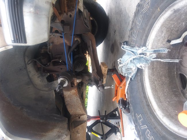

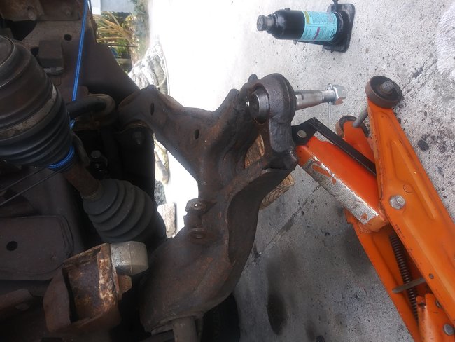

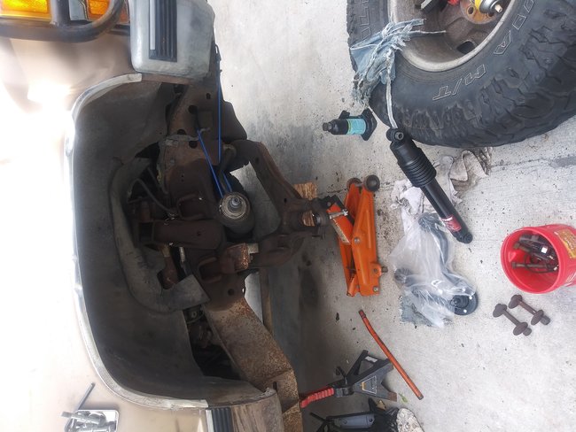

I am using the 67045 kit from the auto O'Reillys. here's the work I've gotten done so far:
Nov 26, 2020 at 1:24 PM
I would suggest releasing the torsion bar and removing the control arm and working on it n the bench to get it in all the way.
Nov 26, 2020 at 3:13 PM
POOPYRYA
  • 17 POSTS
That helped, thank you! Just releasing the torsion bar was all I had to do, didn't have to take off the control arm at all! Lucky me, thank you!
