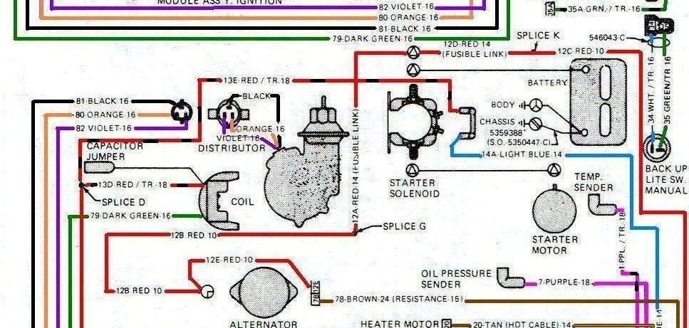

Hi guys. Maybe I can clear up some of the confusion. Fuse link wires are just a piece of wire. There's nothing inside them like fuses or lumps. The wire is a standard copper wire, but it is of a smaller diameter than the rest of the wires it protects. That makes it the weak link in the chain, so it is what burns open. For legal and safety ramifications, that link can not be replaced with any old piece of wire of the same gauge. Unlike regular wire, the insulation on fuse link wires will not burn or melt. It will be a dull color, . . . much different-looking than normal, shiny wire. The color denotes its current rating. You can buy replacement fuse link wire at any auto parts store. Typically you'll get about 12" which is plenty to make two or three repairs. The length of the section you splice in is not important.
To test a fuse link wire, just tug on it. If it acts like a wire, it's good. If it's burned open, it will stretch like a rubber band. Since these are always under the hood where moisture is an issue, always solder the splices, then seal them with heat-shrink tubing with hot-melt glue inside. Never use electrical tape in a car or truck. It will unravel into a gooey mess on a hot day.
A fuse link wire should not be replaced with a fuse holder and fuse, even of the correct current rating. Some people do that when there's an intermittent short that is hard to locate. The problem is the wire takes some time to burn open and it can hold up to a momentary overload such as when a motor draws high start-up current. A regular fuse used for a radiator fan motor, for example, would pop as soon as the motor turned on, but the delayed action of a fuse link wire would prevent it from burning open.
One problem with fuse link wires, when you're diagnosing a dead circuit, is when the wire burns open, it leaves a carbon track behind, similar to what is found inside a distributor cap that got wet. That carbon can conduct enough current that a digital voltmeter can "see" the 12 volts coming from the battery. You can't get enough current through that carbon, so the circuit is dead, but the voltmeter incorrectly says everything is okay up to that point. This is where an inexpensive test light is much more accurate than the voltmeter. Voltmeters work by detecting voltage. That's easy to do. Test lights work by current running through the bulb to make it glow. That can only occur in a circuit that is really okay.

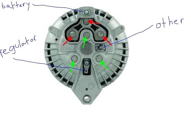

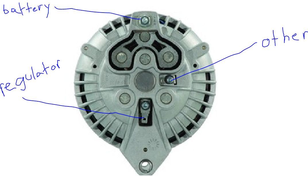

As a point of interest, I added some nifty arrows to the photo to show the diodes. The green arrows are pointing to the three "negative" diodes. Diodes all have two terminals and a polarity. Here the term "negative" just means which of those two terminals goes to ground. It is attached to the metal cover that is pressed into the alternator's rear housing. The red arrows point to the "positive" diodes. The metal block they're in is insulated from the rest of the housing, and it is where the output terminal is attached. That's the "battery" terminal is this dandy photo.
These diodes had an uncommonly low failure rate, but any time one diode fails, the most you'll be able to get under full load is exactly one third of the alternator's rated capacity. The full rated output for cars with air conditioning was commonly 55 amps, so if you found around 15 to 20 amps during the output current test, you knew there was a bad diode.
Not to complicate the issue unnecessarily, output current starts at ground, flows through a diode, one third of the stator winding, through another diode, then out to the battery's positive post. Those diodes are all that stands in the way of a direct short to ground. If one diode shorts, you still have the three in the other group to block current flow. It's when you have any one negative diode shorted AND any one positive diode shorted, that you have a dead short, lots of current flow, and a burned-open fuse link wire. Be aware the size of that fuse link wire depends on the current rating of the generator installed at the factory.

Here's where I get to impress you with the problems you're running into. The original 1960 – 1969 alternator can only be used on those years, with the mechanical voltage regulators. It is impossible to use them on the 1970 and newer models because you need that second brush / terminal to be insulated from ground. The opposite is not true for the 1970 – 89 version. If you want to use it on the earlier cars, all you need to do is hook the blue wire to either one of the terminals, and ground the other terminal. In fact, you'll see there's a fiber insulating washer under the screw heads. For many years we were given a separate metal washer with a rebuilt alternator to replace the fiber one. If you installed the metal washer on the second terminal, it became a 1960 – 69 model.
Testing these systems was real easy and fast. The first thing to be aware of is it is physically impossible for an AC generator to develop much more than what it is designed to produce. If you have a 55-amp alternator, that's all you can hope to get during a full-load output current test. To do that test, you need to make the magnetic field as strong as possible. That simply means eliminating the voltage regulator and the restriction to input current flow it presents. To say that a better way, you need to ground one field terminal and apply full battery voltage to the other terminal. The manufacturer always gives you one of those. You have to supply the other with a jumper wire.
In the first version, one brush was already grounded. You need to supply battery voltage to the other terminal. Touch a jumper wire between that terminal and the battery's positive post, or from that terminal right to the alternator's output terminal. The system is now charging wide open. Voltage can rise to dangerous levels that can destroy computers and any light bulbs that are turned on, so we only do this for a few seconds, . . . just long enough to take a current reading. At the same time we're doing this, we have a load tester connected to give that current a safe place to go. Since all generators are inefficient at lower speeds, it is customary to raise engine speed to 2000 rpm during this brief test. This is also called the "full-field" test because the field winding has full battery voltage across it. That will never occur once the regulator is back in the circuit.
This full-field test gets even easier on the newer version. 12 volts is always applied to the terminal with the dark blue wire. We have to supply the ground to the terminal with the green wire. That can be done at the voltage regulator's plug, but it's way much easier at the alternator. Just grab a screwdriver, touch the tip to the terminal, then flop it over to touch the housing at the same time. You just bypassed the regulator to make the system run wide open. Remember, the terminal is insulated from the screw head, so this won't work if you have the screwdriver on the screw instead of on the terminal.

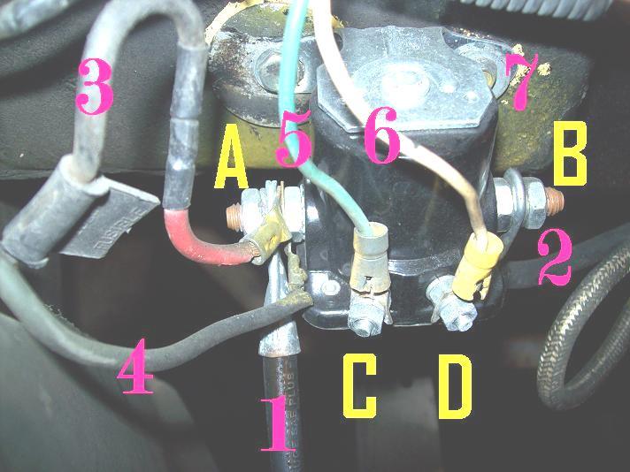

I have to add one important word of warning. NEVER, NEVER, ever remove a battery cable while the engine is running, on any car. That was a trick used by mechanics years ago who didn't understand how these simple systems work. The thinking was if the engine kept running, the alternator must be good, but if you think I'm typing a novel now, just wait until I explain why an engine can stall even though the alternator is good, and it can stay running when the alternator is defective. This is not a valid test. Also, the battery is part of the team that lets the voltage regulator do its job. Without the battery in the circuit, system voltage can easily rise to as high as 30 – 35 volts when you increase engine speed. I did that every year on the test bench to show my students why that would destroy numerous computers. On the older models without computers, it can destroy the alternator's internal diodes, voltage regulator, radio, and any light bulbs that are turned on.
If you're burning up a wire, check if your replacement alternator has that one fiber washer replaced with a metal one. If it does, and you connect the green wire there, the alternator will be full-fielded all the time and you'll damage the battery from severe over-charging. If you connect the dark blue, (or red, if that's what is used on your truck), wire there, you'll have a direct short to ground. There's no fuse link wire to protect that part of the circuit, but there will be one further back in the circuit closer to the battery. If that burns open, you'll have more than just a dead charging system. Most likely the ignition system will be dead too, so the engine won't start or run. It's also possible for just the wire between the splice and where it goes to the alternator's terminal to burn up, especially if that section is a smaller diameter wire. Remember, that wire only has to pass a maximum of three amps, and that is only during full-field testing.
