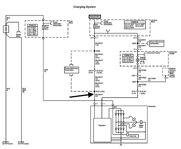

The 14.6 volts you found earlier is perfect, right in the high end of the acceptable range of 13.75 to 14.75 volts. Check that again when the problem is occurring. If the battery voltage is still within that range, the voltage regulator is defective. It is turning the "Battery" warning light on when it shouldn't be.
If you find battery voltage has dropped to around 12.6 or less, check the voltages on the back of the generator. The large bolted-on wire must have the same voltage as you found at the battery. If it is significantly different, suspect the large bolted-in fuse has a loose connection.
Next, check the voltage on the black / white wire pointed out in this diagram. It must also have full battery voltage on it. Fuses are not intermittent, but they can be loose in their sockets. That could cause an intermittent problem, but a better suspect would be loose or corroded mating terminals in the connector shown in that circuit.
If those voltage on the wires are okay while the problem is occurring, the generator is the logical suspect.
