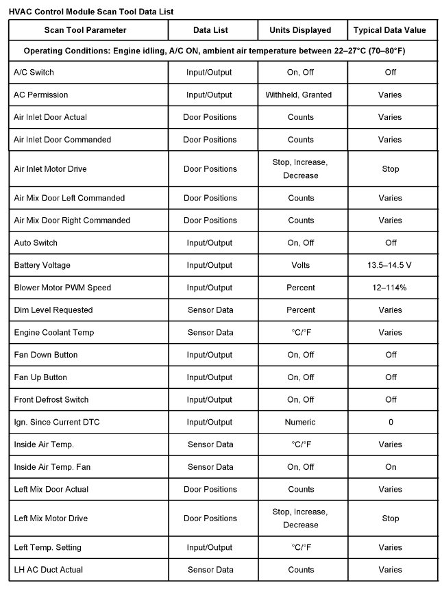

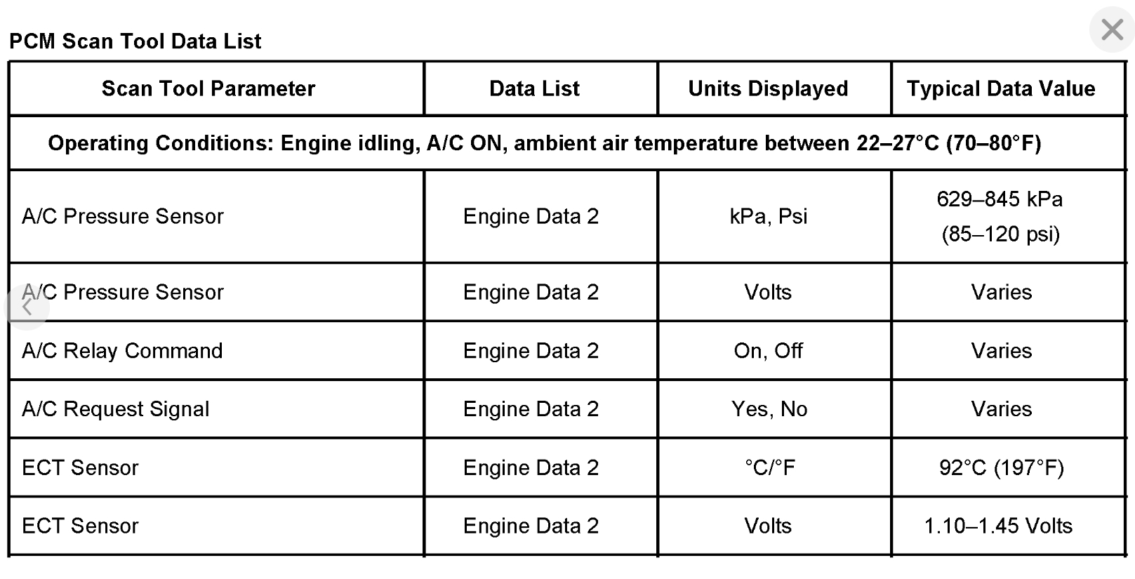

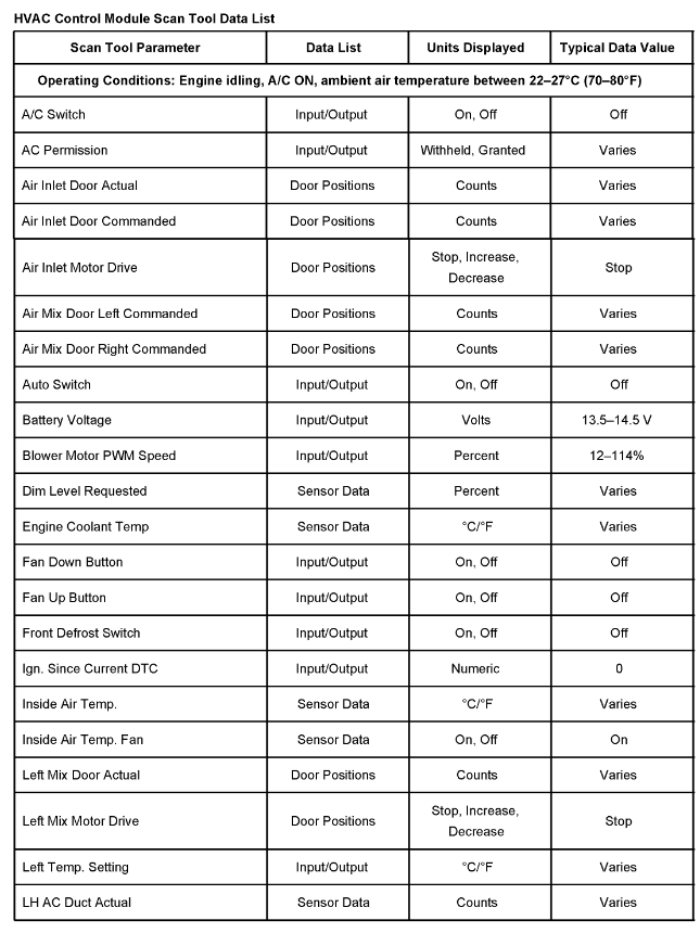

I just found under a TSB that in some cases the A/C compressor will not be allowed to come on if there are Trouble Codes stored in the ECM. So, you may want to scan it for any codes as well. I'll check the rest of this for any other conditions that may impede the compressor's operation. Did you replace the Expansion valve or TXV when you replaced the interior A/C components?

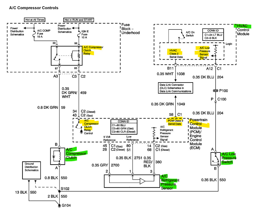

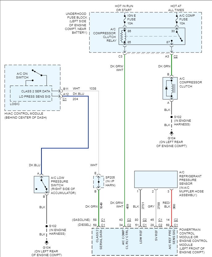

As check the cabin air filter is clear, the engine idle is not too low or unstable, cooling fans operating, overcharged/ undercharged, A/C high pressure switch on compressor looks like a pressure transducer 3 wire- 5volt, Ground and Signal.

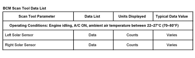

And the Low-Pressure switch on the Accumulator just Grounds the circuit threw the switch so the dark blue wire should be Grounded, and the HVAC control module will turn on compressor through GM 2 Serial Data to PCM and PCM then grounds the A/C compressor relay to engage the clutch.
