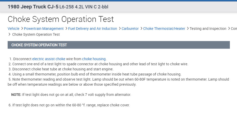

What you described as far as starting is likely either the electric choke isn't working, out of adjustment, or if it sits long enough, the fuel in the float bowl can evaporate. If that happens, it takes some cranking for the mechanical fuel pump to refill the bowl.
If you want, I attached the directions below for testing the choke. Take a look through them and let me know if you are comfortable performing the directions. Also, we have a guy on here that knows these vehicles inside out. I'm hoping he jumps in if he has other ideas.
joe
See pic below.
