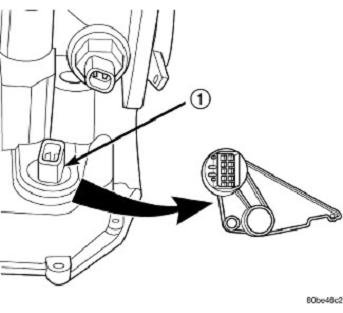

Your car doesn't have a neutral safety switch like we're used to seeing. It uses a transmission range sensor as an input to the Transmission Computer. When that computer detects a problem, it indicates that by the way you observed the lights on the dash.
The sensor is in the same place the neutral safety switch used to be on older models. That is on the corner of the transmission closest to the left front corner of the car. The transmission pan must be removed, then the valve body must be removed, to replace the sensor. This job should take 0.8 hours if the car is on a hoist.
