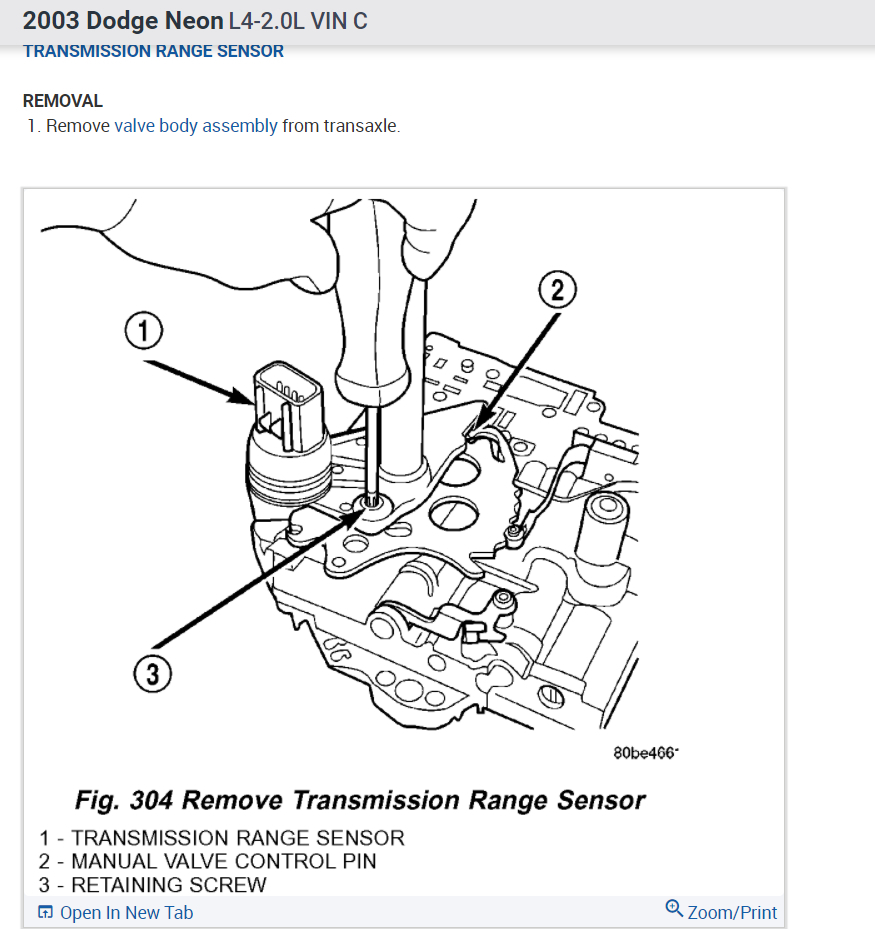

I would like to know how to change neutral safety switch

Replacing the transmission range sensor requires removing the valve body from the bottom of the transmission. Check out the diagrams (Below). Let us know what happens and please upload pictures or videos of the problem.
