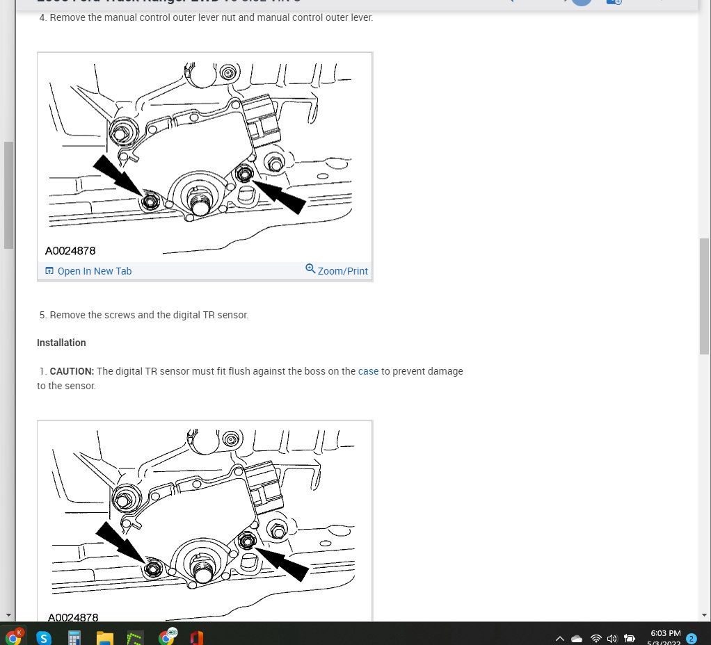

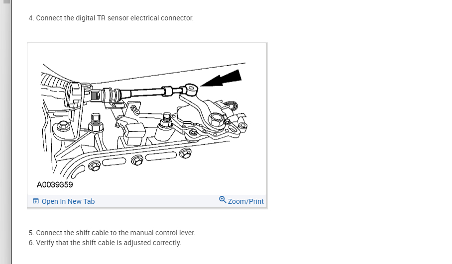

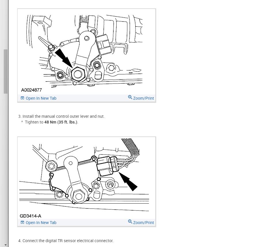

Replacement transmission a little while back with a used one truck has only been starting in neutral since. Is there a certain specs or procedures to aligning the neutral safety switch correctly? I tried to adjust the one on the transmission and now my truck won't start at all, it just cranks over. I've tried moving the neutral safety switch a little at a time and it just seems like it goes from cranking to no crank at all like I can't seem to find the correct position! Any advice or help is greatly appreciated as this is my only means of transportation!
