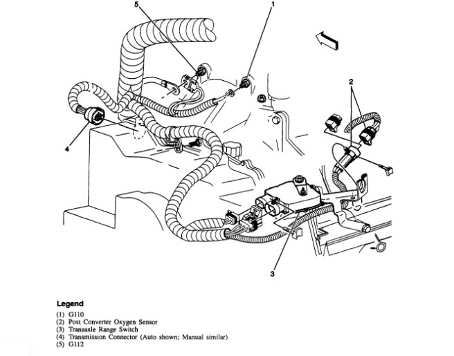

Good evening,
Remove the 15mm nut on the shift linkage and then the connectors for the neutral switch. Remove the attaching screws and lift it up and off.

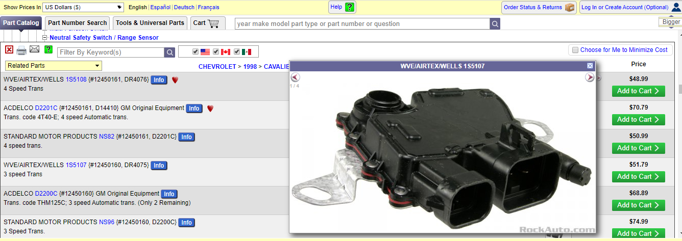

52,796 POSTS
Just remove the 2 attaching bolts. I attached a picture of the screw locations.
