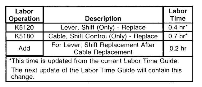

Parts Information
Part Number Description 26056013 Automatic Transmission Control (Gear Shift) Lever Asm (without NW9 - Traction Control) 26056014 Automatic Transmission Control (Gear Shift) Lever Asm (with NW9 - Traction Control) 25713786 Automatic Transmission Range Selector Lever Cable Asm 14094899 Automatic Transmission Control Lever Bolt/Screw
Parts are currently available from GMSPO.
Warranty Information
See Picture 1
