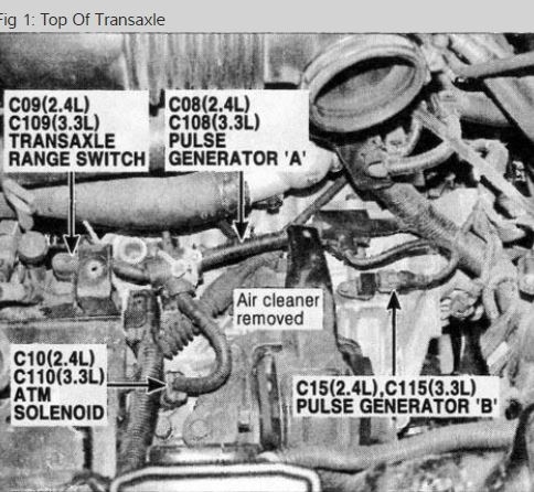

The neutral safety switch (trans-axle range switch) is located on the top of the trans-axle. I attached a picture of its location
Let me know if this helps. Also, a faulty switch will set a diagnostic trouble code. If the check engine light was staying on, you may want to scan the computer to see if one exist.

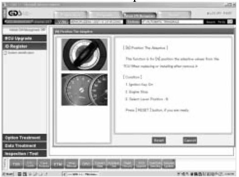

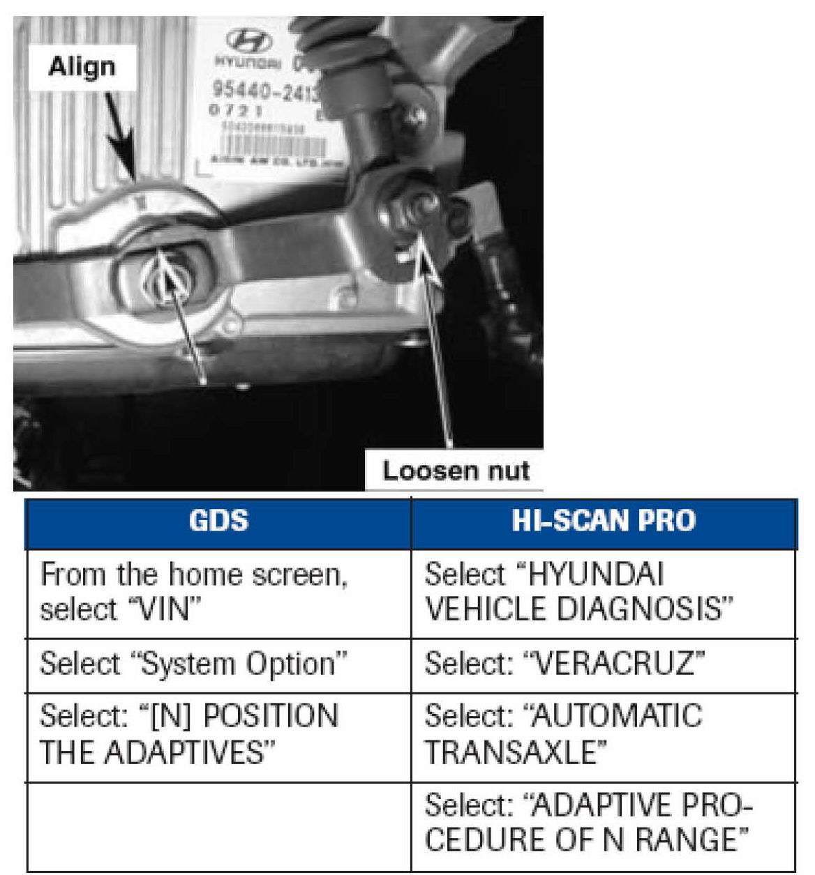

I did some digging and found if it doesn't start after switch replacement, it may need to go through a neutral relearn. This requires a scanner. I have to be honest, I have never had this happen, but under technical service bulletins, I found this. Before we assume this needs done, confirm the lever is properly positioned. See picture 1
RANGE SWITCH "N" POSITION LEARNING:
^ Stop the vehicle, move the shift lever to "N" and set the parking brake.
^ Turn the ignition switch "ON (engine off)."
^ Loosen the nut on the shift cable. Align the dot (o) on the shift lever to the "N" mark on the TCU.
Tighten the nut on the shift cable.
Picture 1
^ Attach the GDS or Hi-Scan Pro.

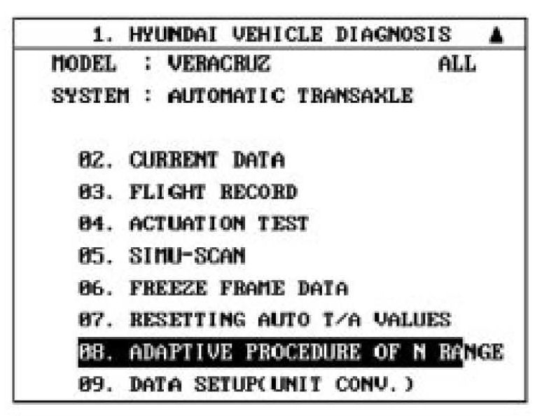

Range Switch "N" Position Learning (GDS):
Picture 2
^ Follow the instructions on the screen and confirm the test indicates "Completed."
(Hi-Scan Pro):
^ Select "ADAPTIVE PROCEDURE OF N RANGE." Press "ENTER.":
Picture 3
^ Confirm the test indicates "Completed."
^ Move the shift lever from "P" to "D" and confirm the shift position indicator on the dash reads correctly. Confirm the correct gear indication using the Hi-Scan or GDS.
