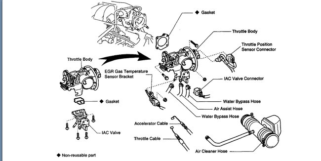

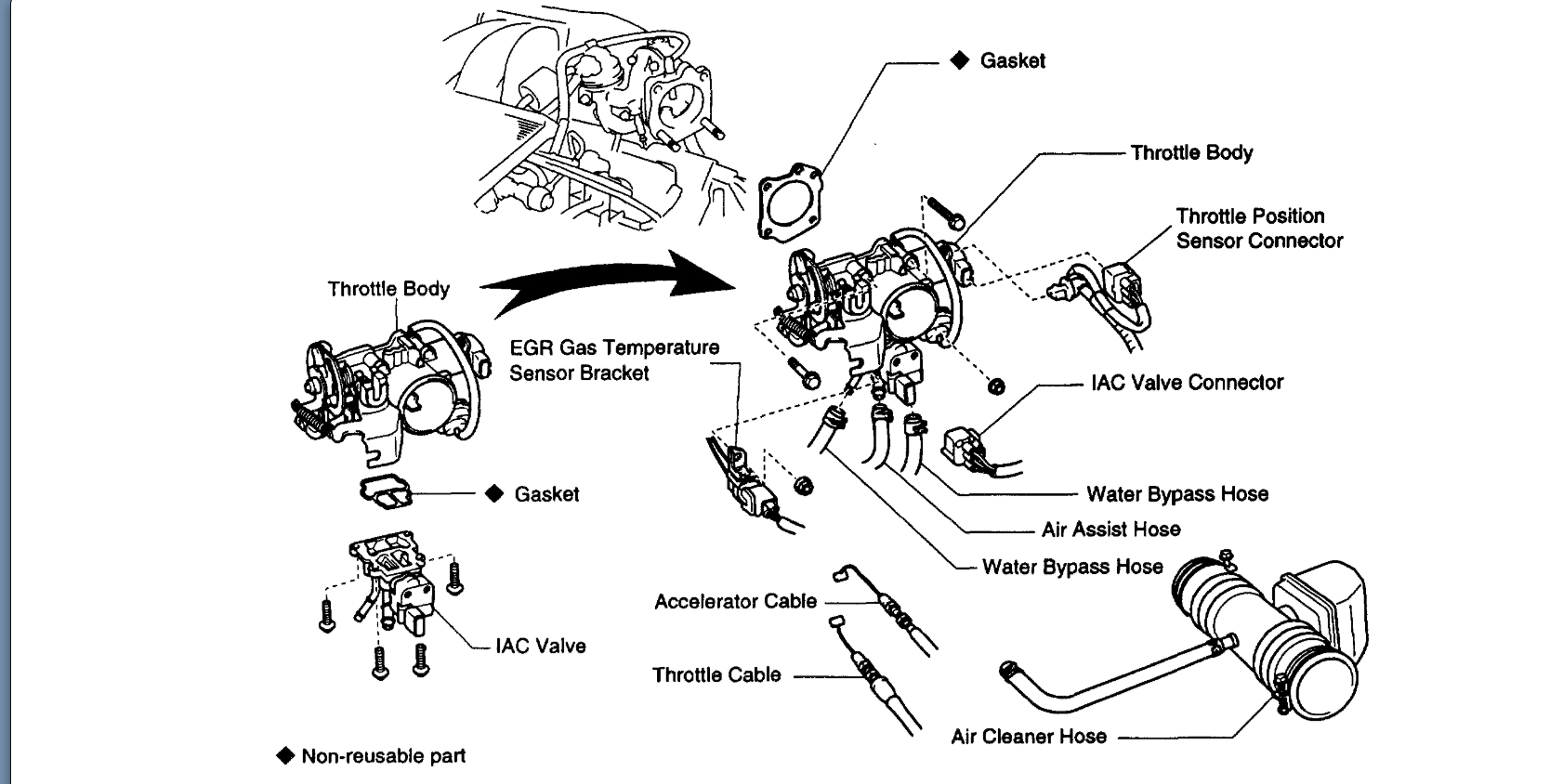

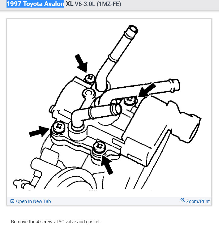

It sounds like you have two problems first the idle. These cars stick the IAC valve due to coking. Here are two guides that can help us get the problem fixed:
https://www.2carpros.com/articles/how-to-replace-an-idle-speed-control-motor-iac
and
https://www.2carpros.com/articles/engine-idles-too-high
The next problem sounds like brake but you will need to make a new post for so we keep the subject matter clean.
Please post your new question here, you must be logged in.
Check out the diagrams (below). Please run this test and get back to us.
