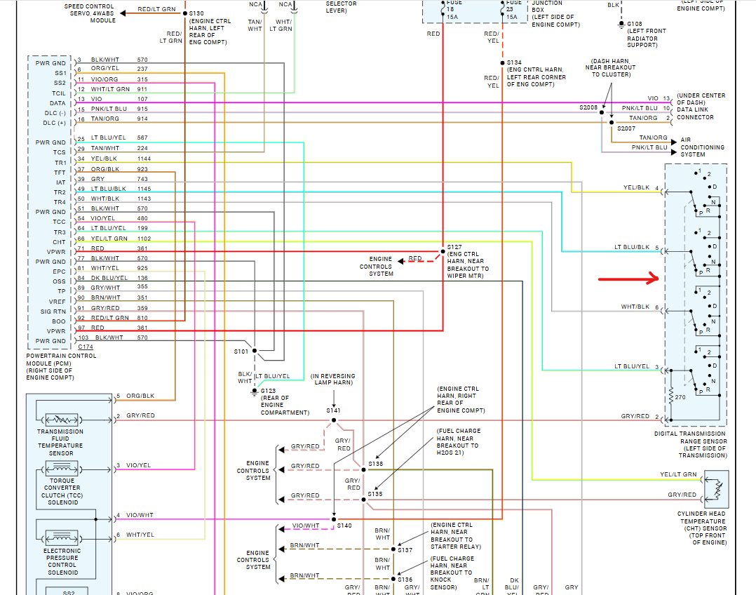

Need wiring diagram for transmission range sensor for Ford 2000 expedition

The old wiring is burnt I have a new plug but there are no colors on the wires.

Sure, here is the wiring diagrams for the digital range sensor. Check out the images (below). Let us know if you need anything else.
