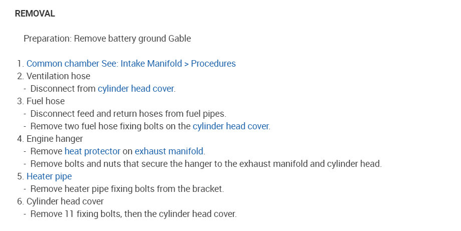

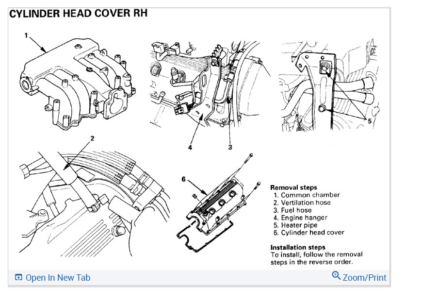

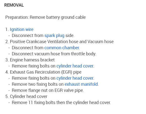

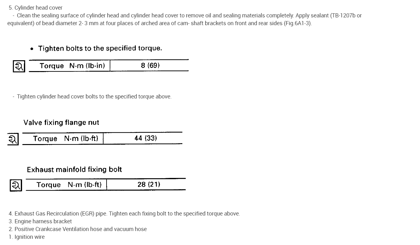

Okay, I was replacing my spark plugs and when I took off the wires, I had oil pouring out of the holes and the spark plugs were just dripping with oil. so, I got the valve cover ready on the driver's side but the left side when looking at motor I can't figure out how to get the lines out of my way to get the cover off without messing up my valves. please help. thanks for the reply.
