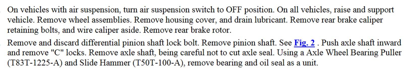

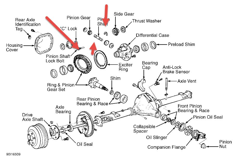

I have slop in the bearing on right side and seal has oil all over brakes and tire.

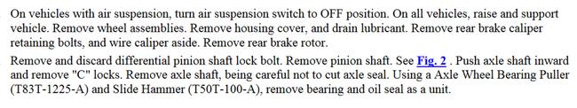

see pics instructions are for disc brakes but drum brake similar.
