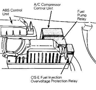

I need the location of the fuel pump relay.

Its located near the ABS control and the ECU. Below is a diagram of the area. Check out the diagrams (Below). Please let us know if you need anything else to get the problem fixed. Tom
