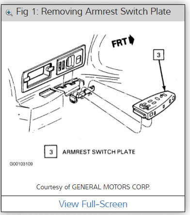

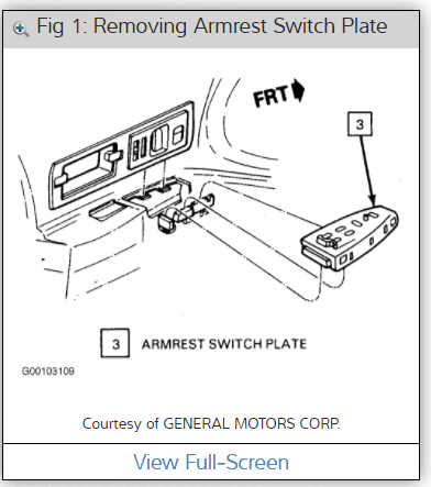

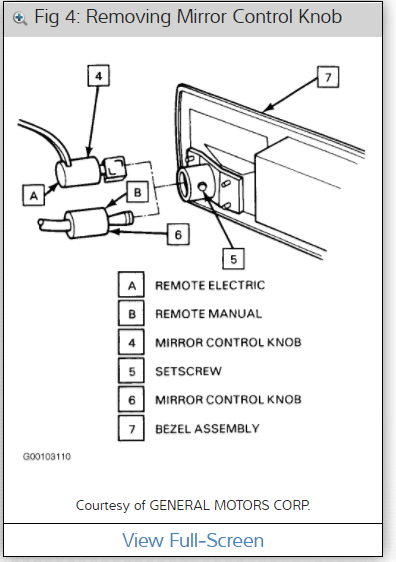

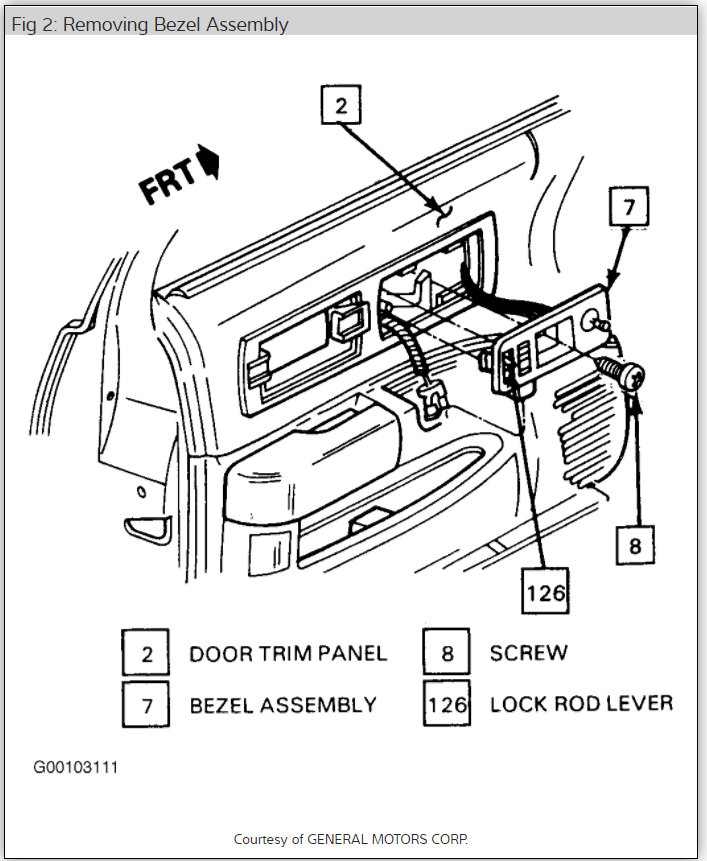

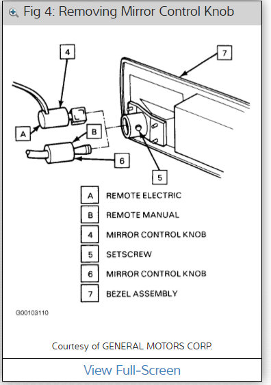

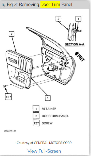

Okay, these are not to bad to replace you will need to remove the door panel this guide will give you an idea of what you are in for when doing the job.
https://www.2carpros.com/articles/door-panel-removal
Check out the diagrams below of how it is done on your car.
