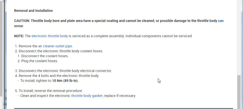

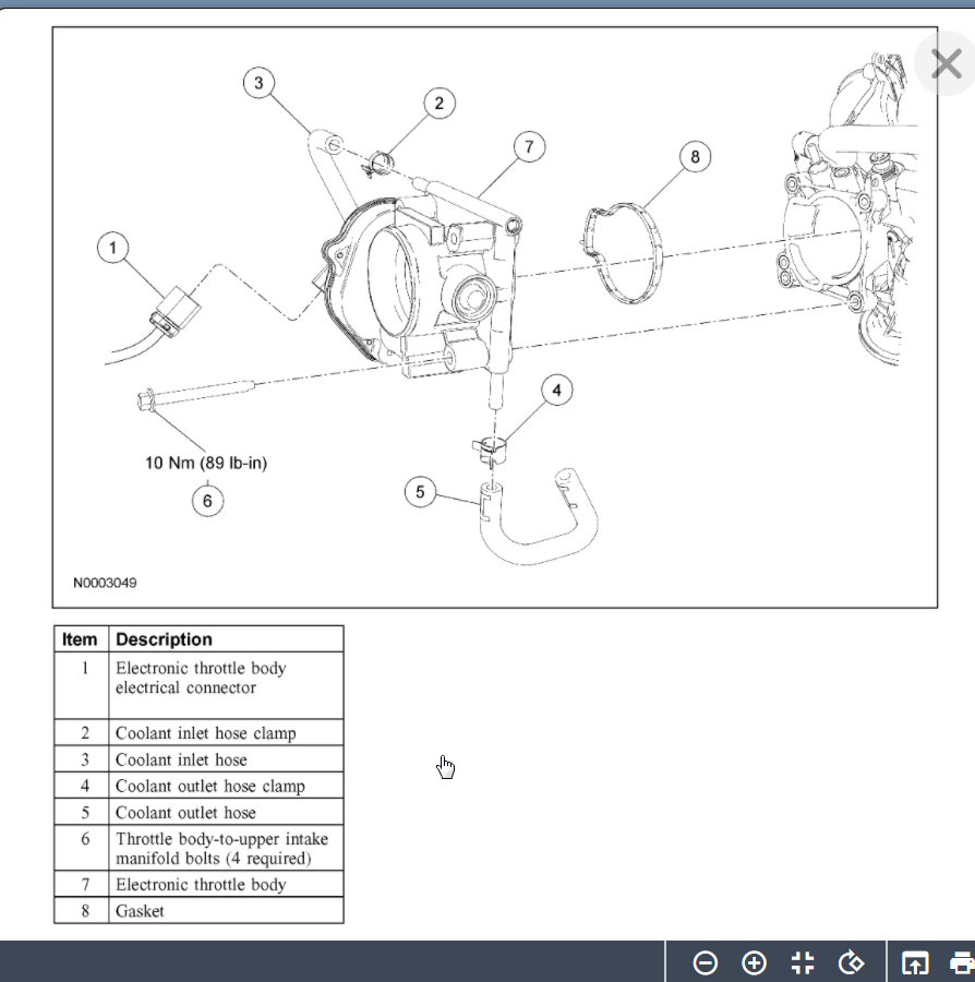

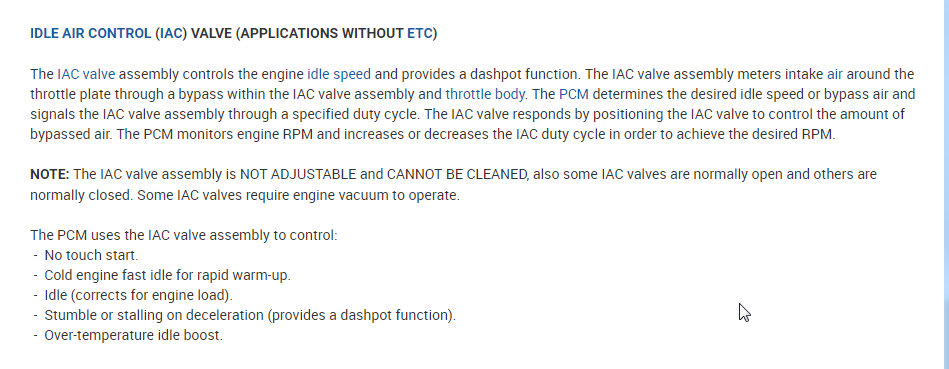

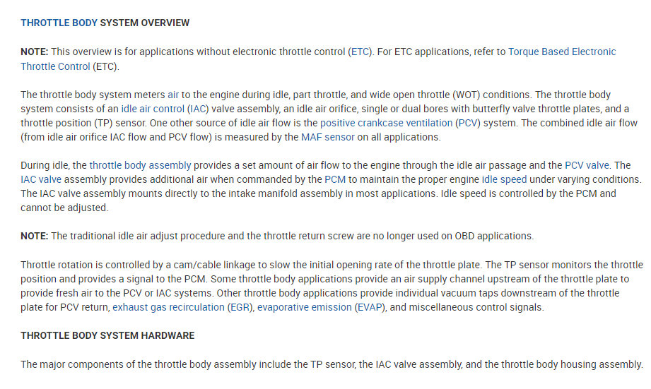

This idle air control on this vehicle is part of the throttle body. I attached the detail below about this. However, do you have a code or some other reason for needing to replace this? If so, what is the code?
Let's run through this material below and let me know if I am misunderstanding. Thanks
