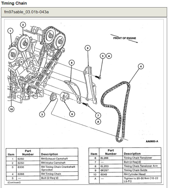

Most of these vehicles in the US, are overhead valve, vin S. vin U is regular cam in block.
The vin number should be driver side of dash, top. Probable easier to see through windshield from the outside.
You might even look under your hood, anything say duratec or Vulcan on the engine? Vulcan should be overhead valve. US duratec should be dohc.
The dual overhead cam will have large valve covers here is what the timing chain looks like.
