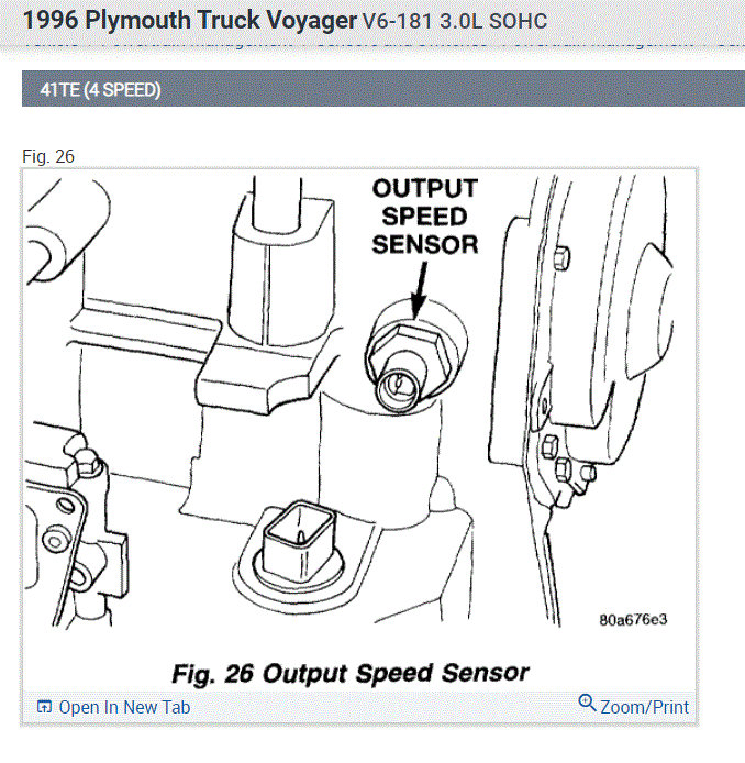

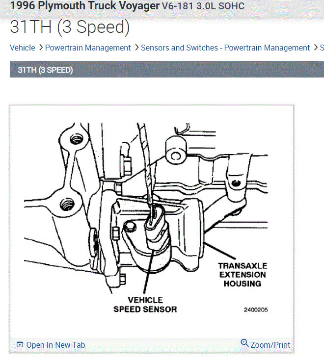

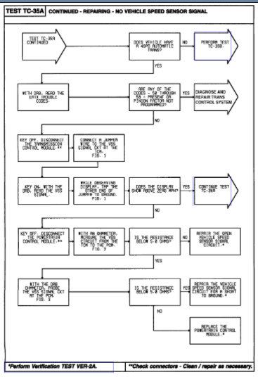

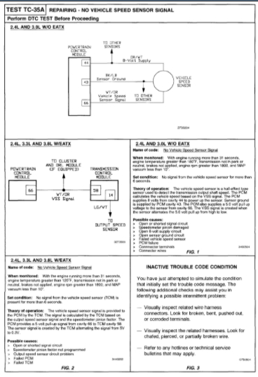

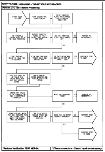

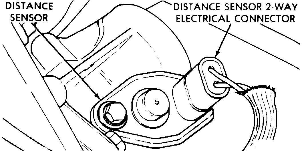

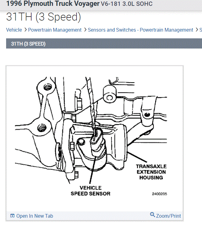

There were two different transmissions used. One was a 3-speed and the other a 4 speed. Pics 1 shows the 3 speed and pic 2 shows the 4-speed sensor location.
As far as replacement, I will provide the directions. The directions are the same. It's the location that is different. The remaining pics correlate with the directions.

1996 Plymouth Truck Voyager V6-181 3.0L SOHC
Procedures
Vehicle Powertrain Management Sensors and Switches - Powertrain Management Sensors and Switches - Computers and Control Systems Vehicle Speed Sensor Service and Repair Procedures
PROCEDURES
Vehicle Distance Sensor

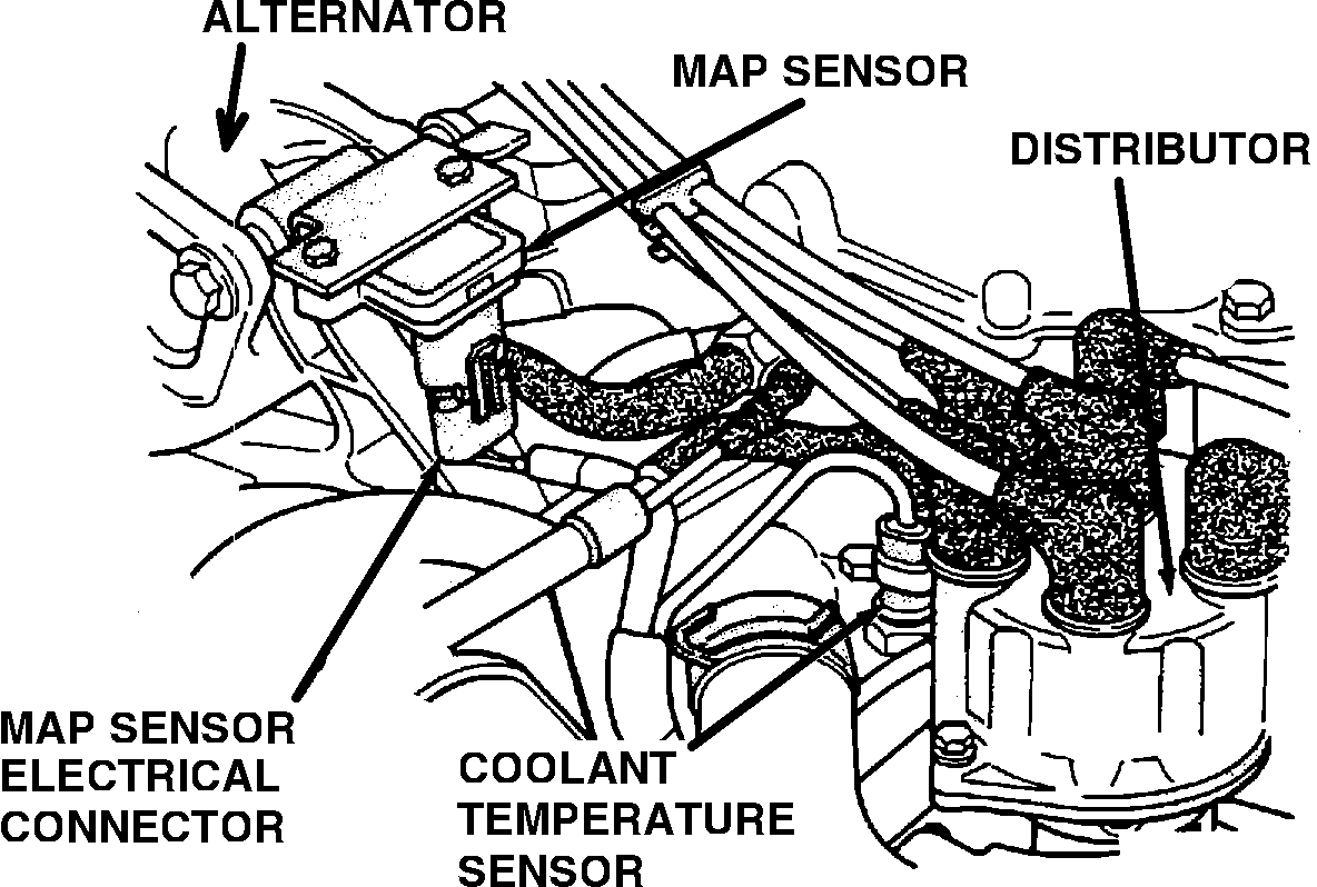

pic 3

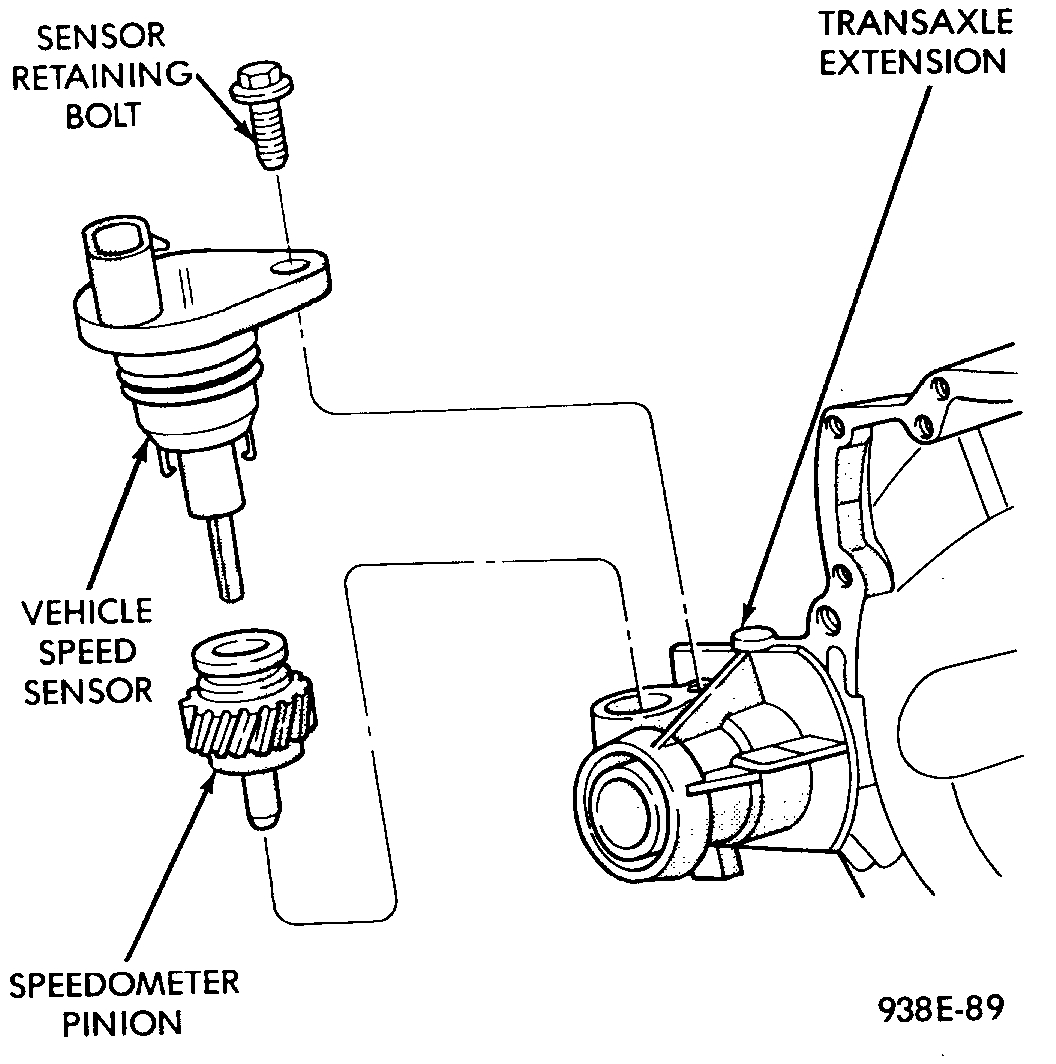

Fig. 8 Vehicle Speed Sensor And Speedometer Pinion

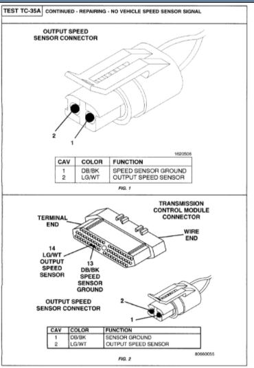

pic 4
NOTE: Applies only to vehicles without 4speed/overdrive (41TE) transmission.
Sensor mounted in passenger side transaxle output housing.
1. Disconnect sensor wiring connector.
2. Use a long extension and a 10mm socket to remove hold down bolt.
3. Pull sensor our of output housing -- may have to rotate as you pull.

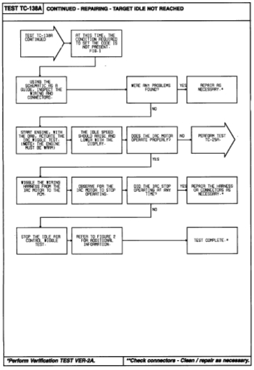

As far as the map sensor, it is located next to the alternator. See pic 5 for location. Here are the directions for replacement.
_____________________________
Procedures
Vehicle Powertrain Management Sensors and Switches - Powertrain Management Sensors and Switches - Computers and Control Systems Manifold Pressure/Vacuum Sensor Service and Repair Procedures
PROCEDURES
Map Sensor And Coolant Temperature Sensor Location
see pic 5 again
REMOVAL
1. Remove vacuum hose and mounting screws from manifold absolute pressure (MAP) sensor.
2. Disconnect electrical connector from sensor. Remove sensor.
INSTALLATION
1. Reverse the above procedure for installation.
I hope this helps. Let me know if you have other questions.
