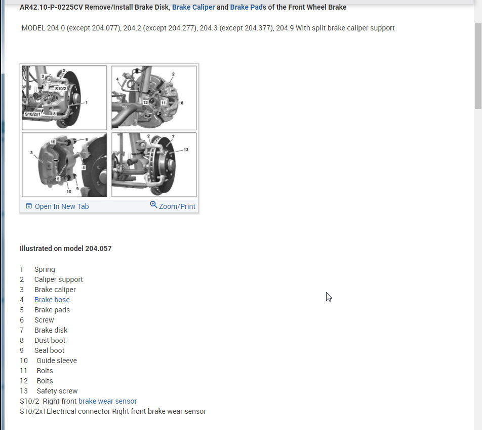

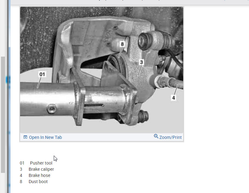

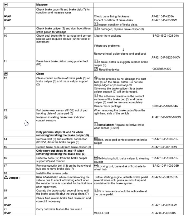

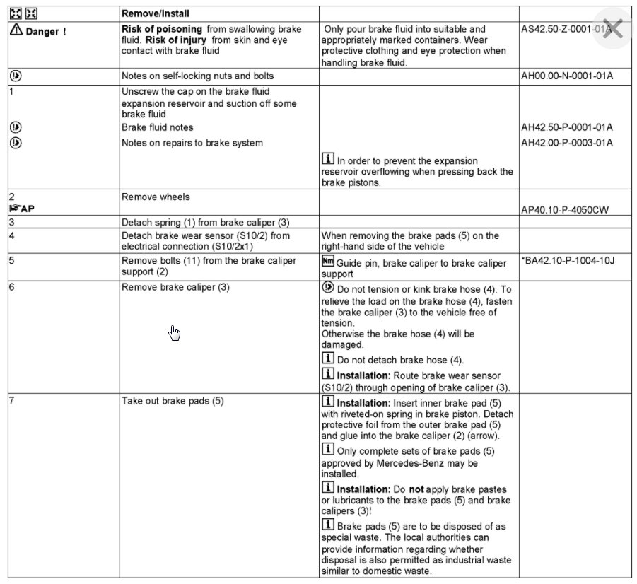

Here is a guide that will help with this:
Plus here is a video that will help as well:
https://www.youtube.com/watch?v=v5hMVIJ1u8k
Lastly below is the process from the manual that will help with getting this completed. Please let us know if you have other questions. Thanks
