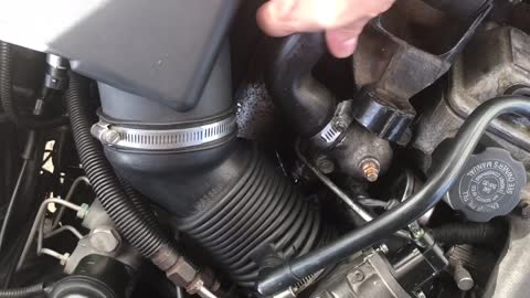

I just replaced a thermostat and coolant temperature sensor. I did a complete coolant flush of the entire system. I also just replaced the intake manifold gasket. So I know I had to drain all the coolant out of the system.
Intake manifold is leak free. But as soon as I started the car after adding coolant, I noticed along side the thermostat housing started overheating. I use rtv on the thermostat housing after putting the new thermostat in to seal for leaks. I am thinking maybe it’s overheating because I used concentrated coolant. I did mix water and used more coolant. I did some research and read that concentrated coolant is known to make an engine overheat if it’s not mixed properly. Many people recommended using straight coolant without adding water. Many had better results and increased the life of the coolant system parts in their cars lasting longer.
I am thinking it’s overheating because I used concentrated. I attempted to flush the coolant again today thinking maybe there was still air in the system somewhere. But when the engine started warming up it began to overheat in the same area again. I am lost. I know my heater core is okay because I have heat. It’s got to be something simple I did wrong for it to overheat like this. I hope it’s just the concentrated coolant. Let me know what I should do. I don’t want to drive it like this. Plus I am a beginner mechanic. If I can fix it myself without paying money I would appreciate how to correct this.

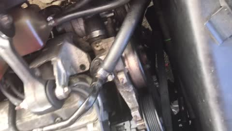

Here are some videos of where it’s exactly overheating at and water pump inspection:

Did you replace the parts to solve this problem or for some other reason? Was the engine overheating before the repairs were done? I'm sorry, but I'm not able to view videos. What are the exact symptoms that lead you to believe the engine is overheating?
As for the coolant, the proper mixture is 50 percent water and 50 percent antifreeze. The antifreeze lowers the freeze point, but it has very little ability to carry heat to the radiator. That's what the water is needed for. It can contain a lot of BTUs of heat and move it efficiently.
Normally when you get hot air from the heater, the coolant has to be circulating to warm up the heater core in the dash, but GM often does things differently. Coolant might circulate through the heater core while an air pocket under the thermostat will prevent it from opening and coolant from getting to the radiator. Thermostats don't open in response to hot air. They have to be hit with hot liquid. If there is no bleeder screw on the thermostat housing, look for a coolant temperature sensor near it that you can remove. Add coolant until it reaches the top of the hole, then pop the sensor back in.
Feel across the radiator too to see if it's hot. If it is, the coolant is circulating. Then the two common things are to insure the radiator fan is turning on, and to perform a chemical test for a leaking cylinder head gasket. Here's a link to an article that explains it better than I can:

The engine wasn’t overheating before. I only replaces the thermostat and the coolant temperature sensor because I had to remove the intake manifold to replace the gasket. Every time I do a job with coolant I replace thermostat and coolant temperature sensor to maintain the cooling system. There isn’t any head gasket leak, there isn’t any milky wet shown in the oil and no white smoke is entering the tail pipe. It is just overheating near the thermostat housing. Like I said in the videos you couldn't see, is the water pump pulley has some play in it and makes noises when I freely spin it without the belt on. Also a symptom of a bad water pump seal would be coolant leaking out of the hole. This is doing so on mine. But if I were going to replace the gasket I rather replace the whole pump because it wasn’t a new one. It was a re-manufactured part.
I mention the water pump because the engine is overheating. I want to make sure if the water pump relates to the over heating issue I am having. Like I said, the only thing that is over heating is the thermostat housing. I do have a bleeder screw, but the screw isn’t bleeding when I open it. I don’t know if there is air trapped in the system somewhere or the pump went out. I don’t want to spend money buying more parts before I know what is it. That’s why I asked for help how to fix it.

Pop a sensor out to bleed any air out. A lot of cars don't even have bleeder screws, so we can work around that.
It doesn't make sense to say only the thermostat housing is overheating. It can only do that if the entire engine is overheating. Did you feel the radiator to see if coolant is circulating?
Milky oil is the least common symptom of a leaking head gasket. The most common ones are the white smoke from the tail pipe and bubbling in the reservoir. With neither of those, we'll assume the head gasket is okay, especially since it wasn't causing a problem before.
Is it possible you're seeing a problem where there really isn't one? A lot of GM engines have to get up to an uncomfortable 226 degrees before the radiator fan turns on. Before you spend any more of your valuable time chasing this, use a scanner to view live data and see what the Engine Computer is seeing for coolant temperature. You can also use the scanner to cycle the radiator fan relay on and off to verify the entire circuit is working.
