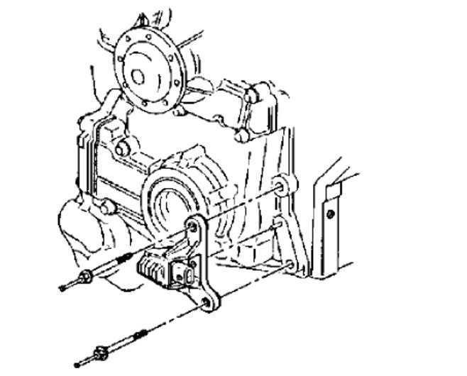

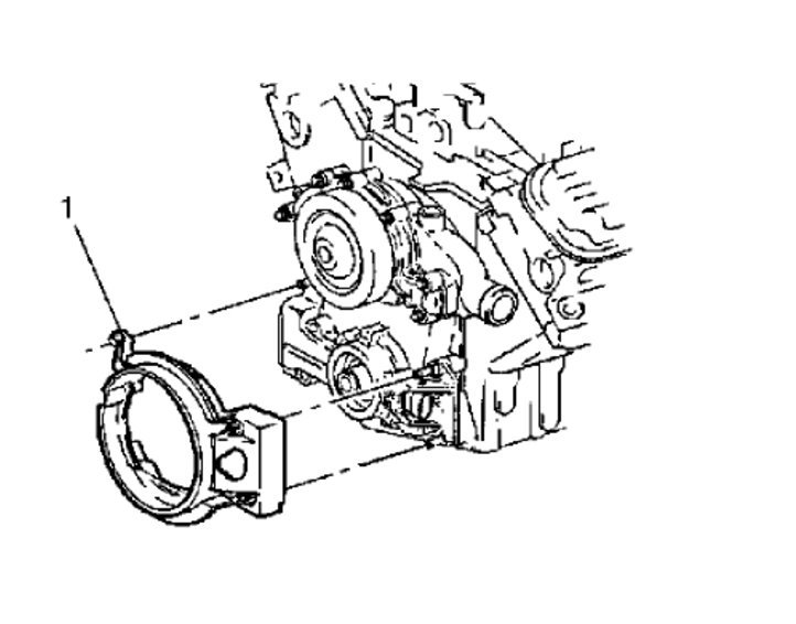

It sounds like you have a crankshaft angle sensor that has gone bad. Here is a guide that will show you what you are in for when changing the sensor out.
and some diagrams on what it will be like on your car. (below)
