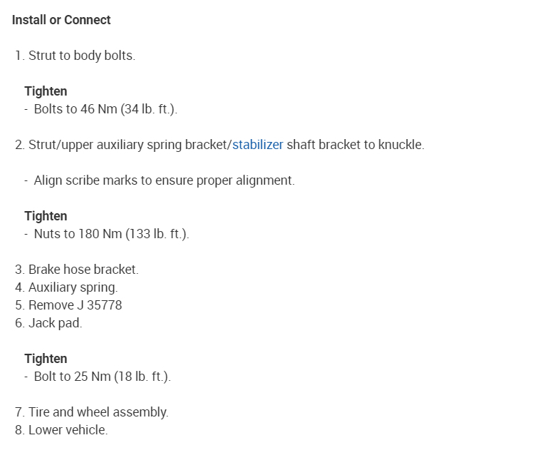

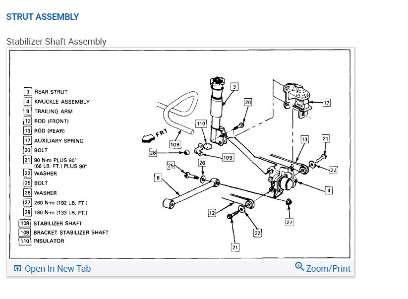

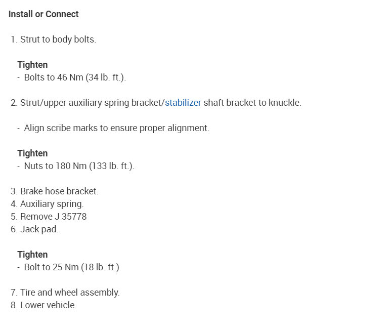

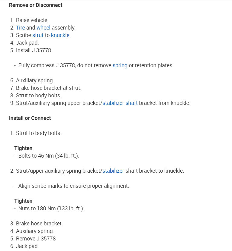

I am replacing the rear struts. I need factory info on how to replace it and what torquing specs I need to tighten the bolts.
Aug 11, 2022 at 9:19 PM
Here is the information on how to change out the rear struts and the torque specs so the job can be done correctly. Check out the diagrams (below). Please let us know if you need anything else to get the problem fixed.
