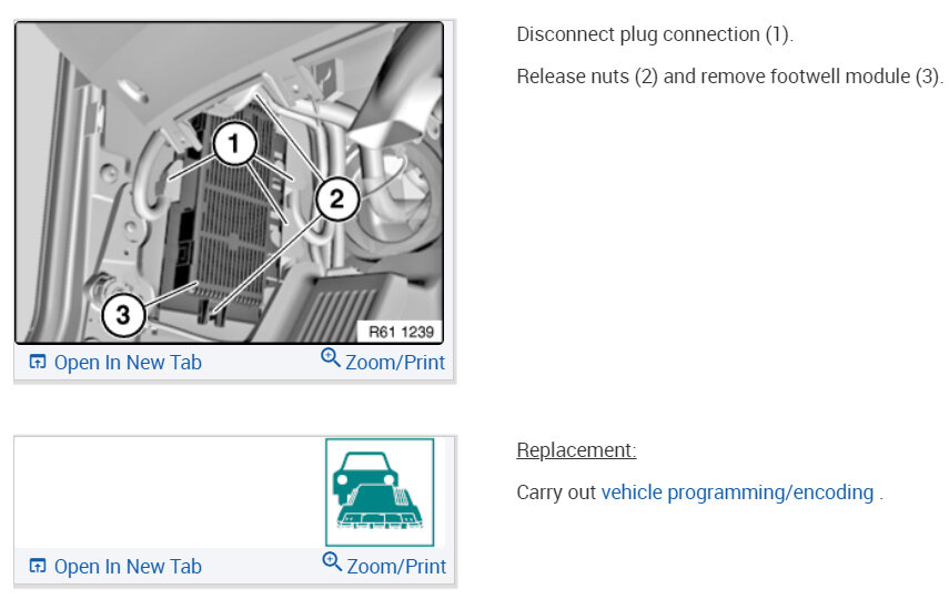

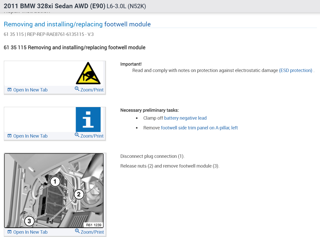

Here is how to change the footwell module out in case a code comes up for its failure. You can get a preprogrammed unit by searching Google or Ebay.
