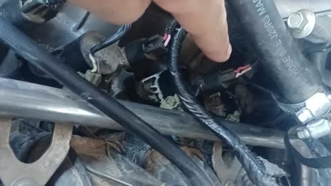

Nice work, so we had a problem with a truck like this and it turned out the spark plugs were counterfeit ones from China. I would recheck the spark plugs for cracks and to make sure they are genuine motor craft plugs, if you got them from Amazon, they are probably fake. Here is a video:
I've seen that video before, lol. thanks. You are right. I bought eBay Motorcraft spark plugs, but I found a loose pigtail connection on a coil pack on piston 3 bank 1.

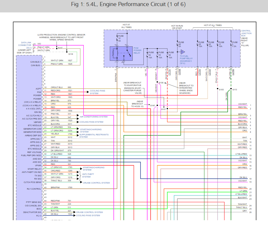

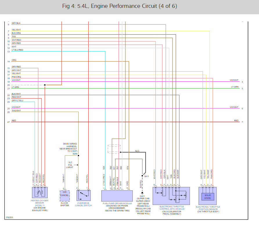

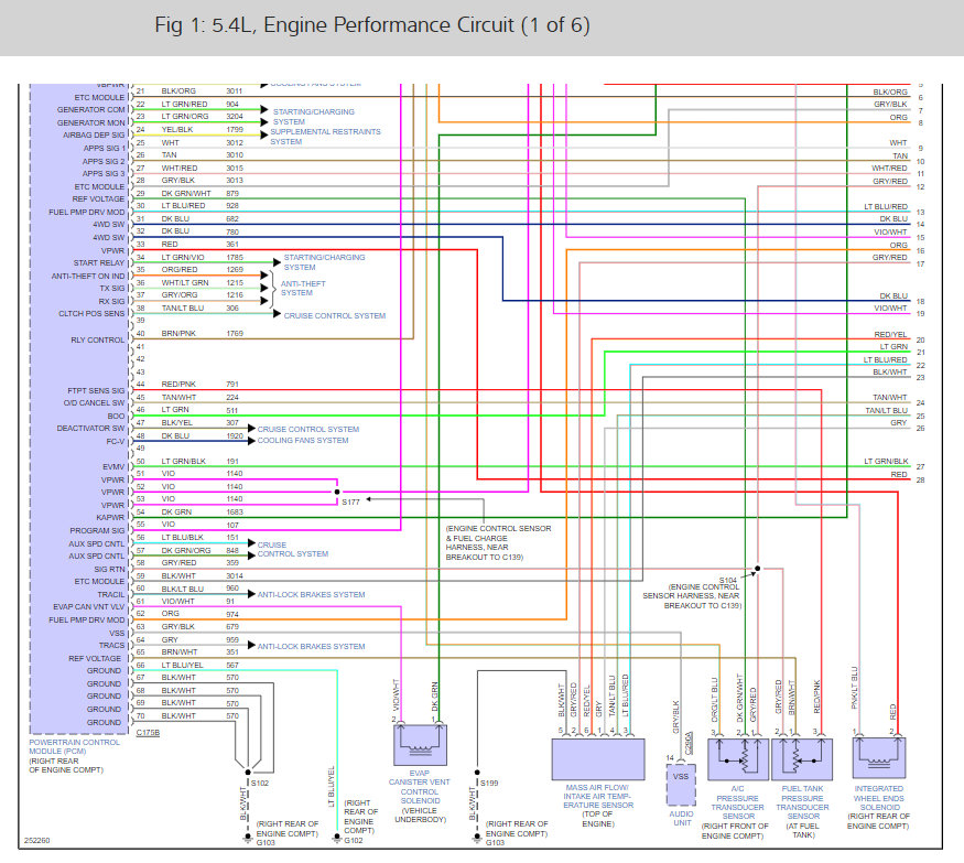

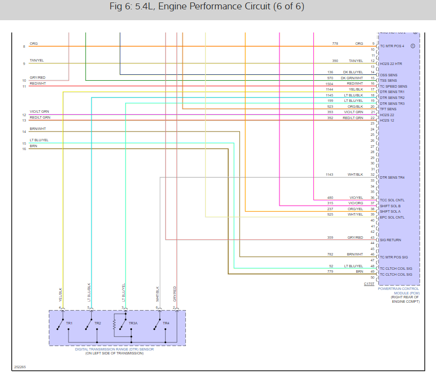

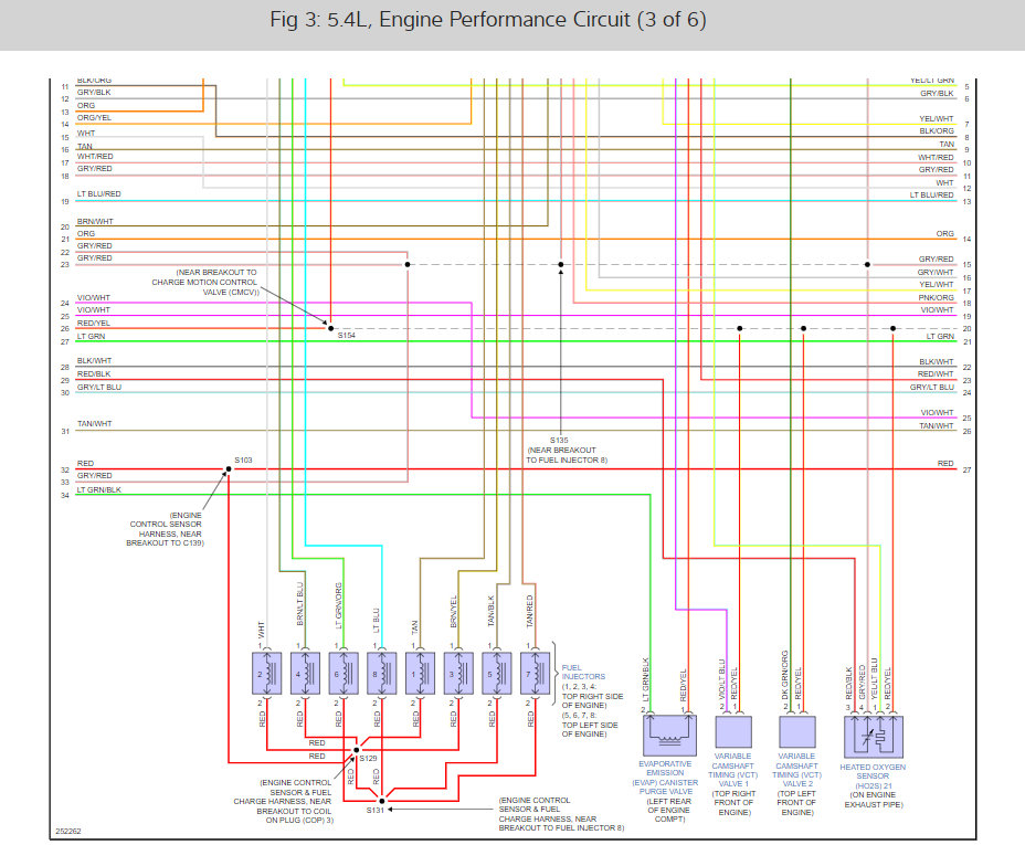

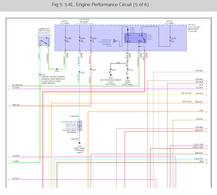

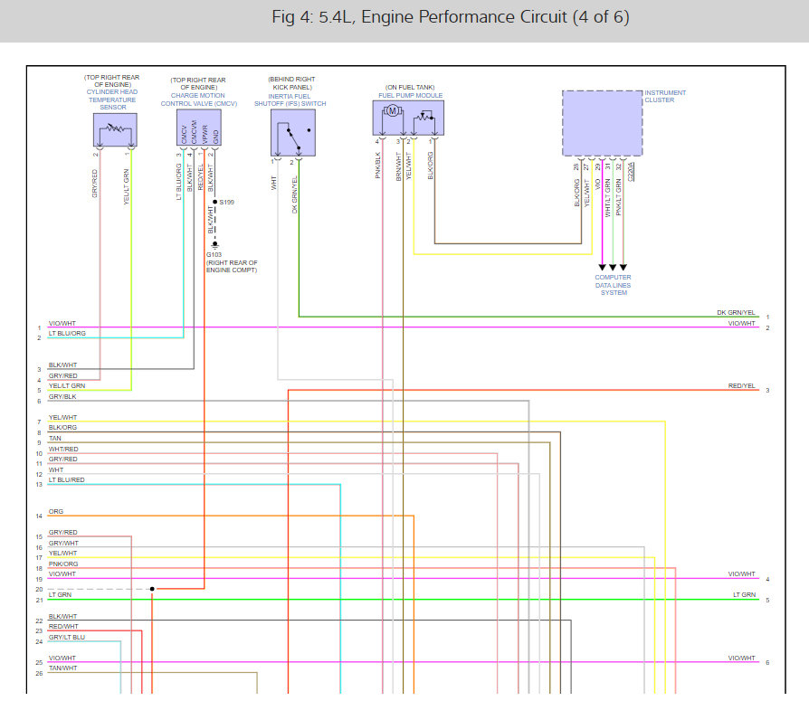

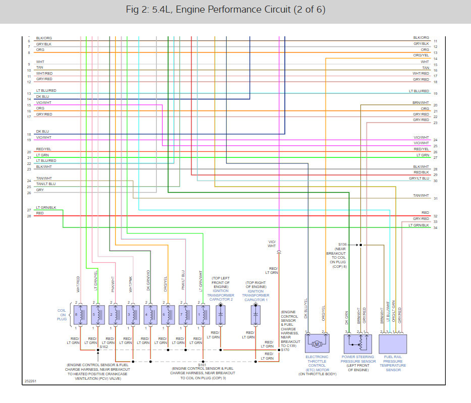

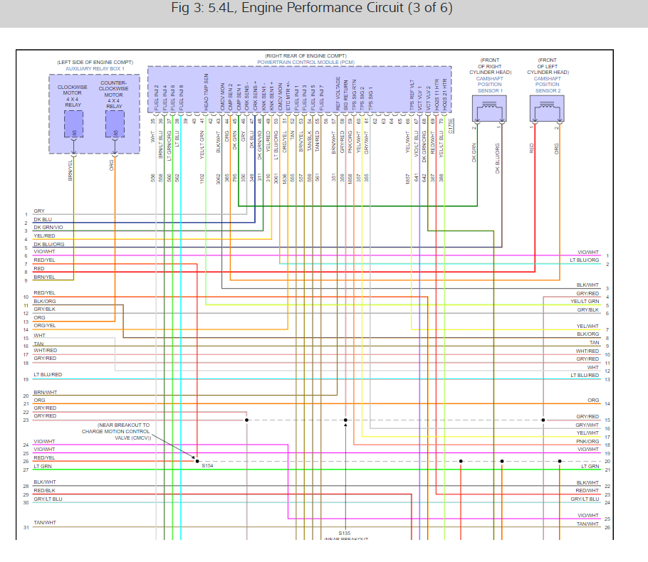

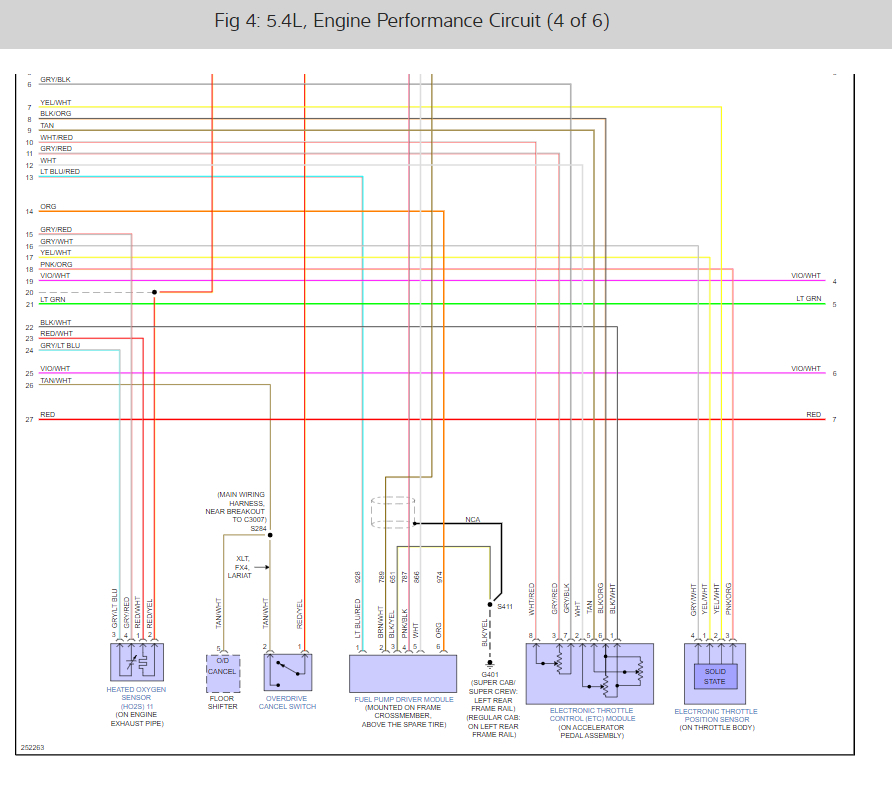

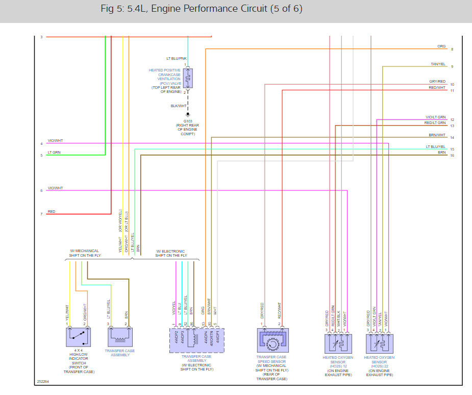

I replaced pig tail. Engine slightly vibrates. I will be changing sparkplug to original. Can you please help me get a fuel pump sending unit diagram? There's 4 plug pin. I have 2 grounds and 2 powers. One gets 12v and the other one gets 7v.
Video (Click to enlarge)
Aug 31, 2022 at 12:11 PM
CERTIFIED EXPERT
53,854 POSTS
Okay, here are the fuel pump wiring diagrams but they are included in the engine wiring, so I have to get you the complete set. You can save this post in your favorites, so you have them for reference later on if needed.
